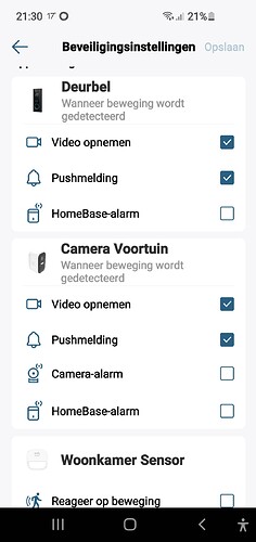

Yeah but it’s not about the Homebase notifications, but the ones for your doorbell and security mode.
So best to check: If there’s motion or any other event do you receive a notification from the official eufy app?
Yes motion is enabled and I receive them fron the eufy app.

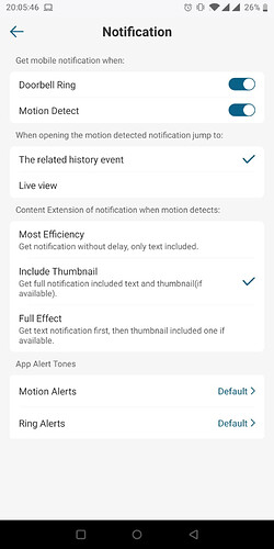

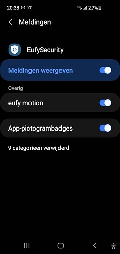

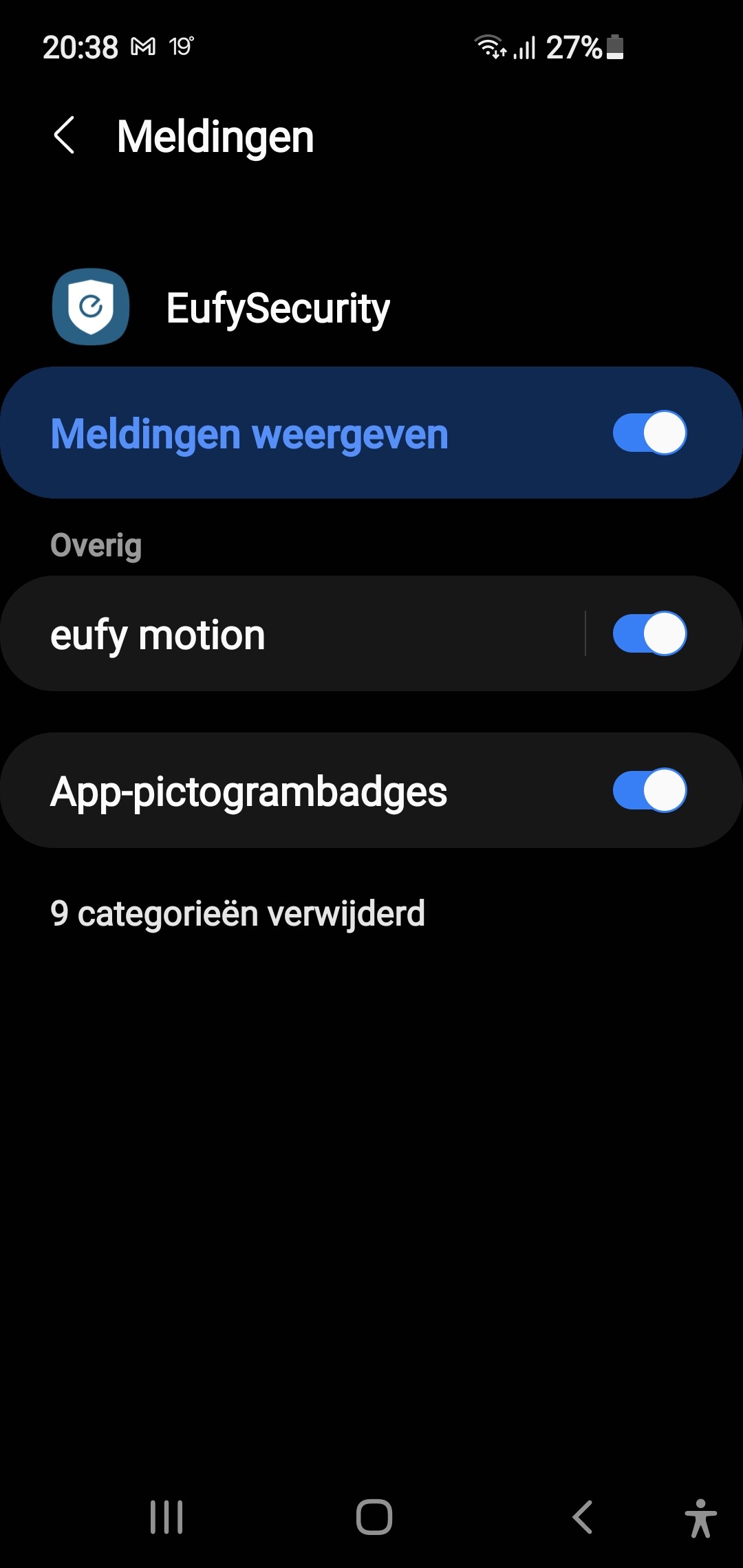

Ok but that’s android notification settings. What about these:
Doorbell images working just fine
