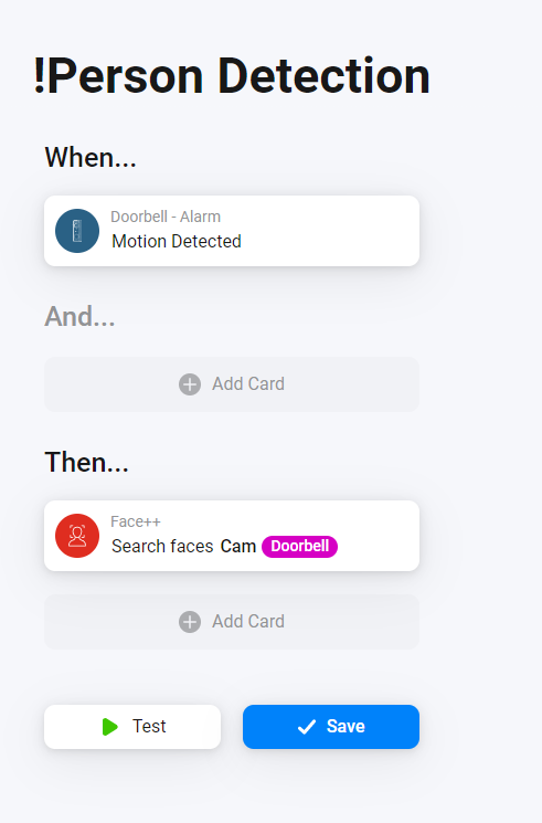

Thanks @martijnpoppen, but the face++ is shit
It detects 1 of 10 if you are lucky, dont know if I did something wrong.
Lets see if other people gets better result than me
Thanks, I have simular setup but mostly it doesnāt work.
Only thing different I have is in the face detected flow. I have an and card with label contains and a name. Sometimes it works but most of the time it doesnāt for me.
Thanks for sharing.
These are my flows.
