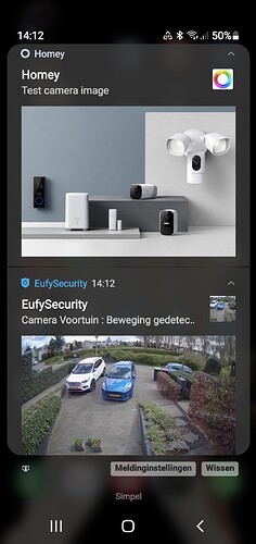

I have found one issue with the 2c pro cam image in the Eufy app for homey.
Eufy doe show me an image in it’s app but with Homey I get either a blank image or the Eufy image. This did work before my Homey died. I use Pipup and there I got most of the time an image of what was happening. Now I don’t get that anymore. Just blank or Eufy image
Here is an example what I see on my phone.

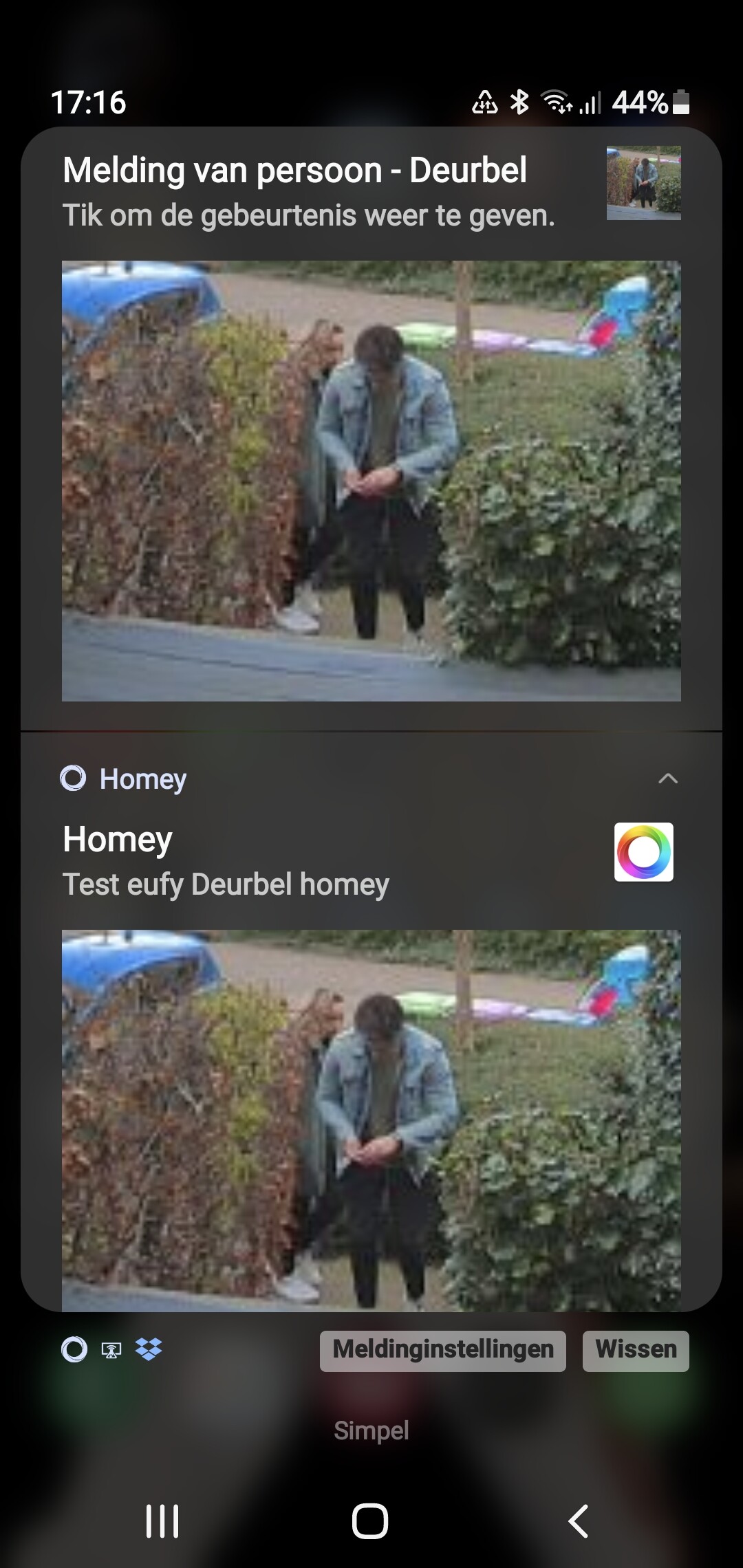

Doorbell images works fine with and is the same as in Eufy.

Unfortunately not. Homey registers itself as a Android device at Eufy. only in that way it can receive the events. If Eufy ever implements user based notifications it will be possible. But until then it doesn’t. only way to fix it is to disable the notifications on your Iphone/Android. (link)
Most of the times this can be fixed with an restart of the app. This issue is still in progress. But it’s quite an long process because I have to delete my devices every time and test motions and do the whole process again :sweat_smile:

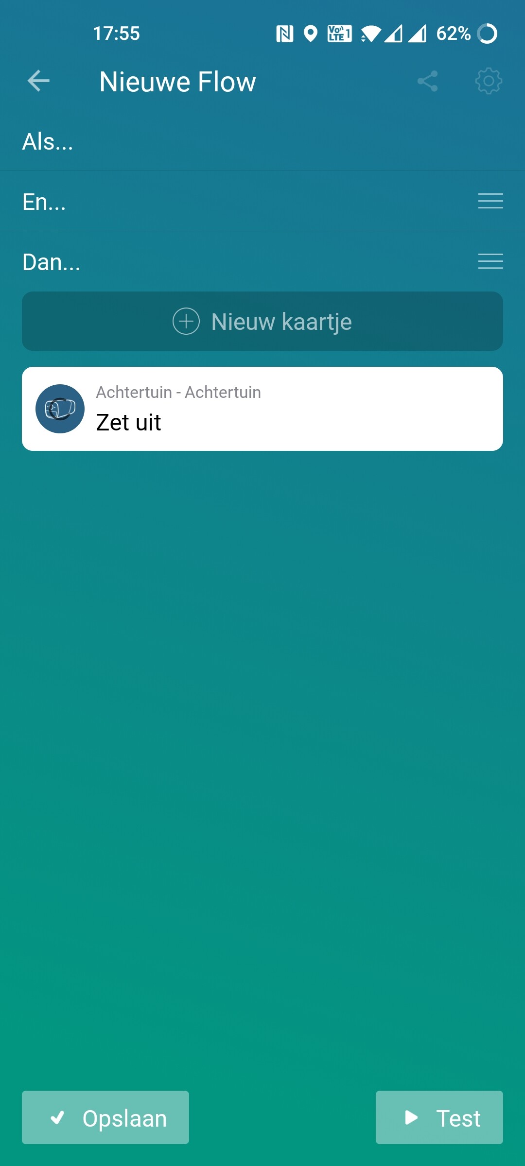

@martijnpoppen would it be possible to toggle the camera’s on / off through flows in the future. So for my eufyCam 2 Pro there is a “Camera aan” toggle in the eufy app. If I toggle a camera off it won’t record or trigger events. I’d like to use this for when my backdoor is open I’m probably in the garden my self and I don’t need Eufy to keep triggering motion alerts or record. So I’d like homey to tell eufy to shut off the camera automaticly.
@Stefan_Lenders ,
This is already implemented in the Homey app. Actually it was the first feature I built :stuck_out_tongue:
So for example with a flow like this:
Well that doesn’t seem to work for my EufyCam 2 Pro camera’s
If I manually trigger the card keeps processing for 30 seconds and then errors.
I’ve just reset the app completly. Readded all devices. But still no succes
@Stefan_Lenders Please check the F.A.Q - Q4
