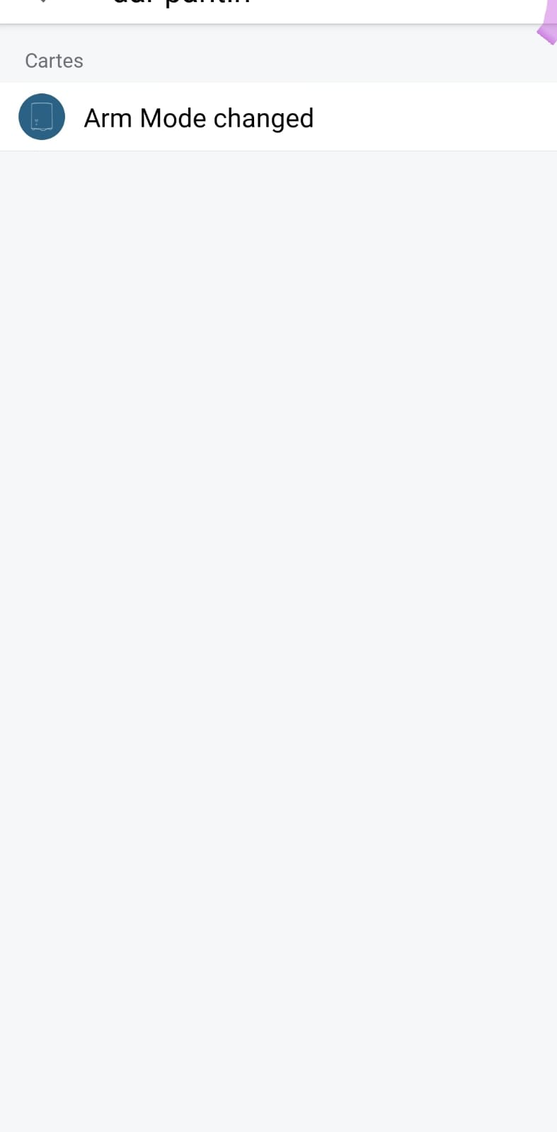

the question is I find no way to get a flow card to signal to homey that an alarm has been triggered.
the Goal is to trigger another Siren that I have on Homey.
when I want to add a new flow, the only card that I have is âArm Mode Changedâ
I have a homey Pro 5.0 with a homebase 2 with a keypad, movement detection , and door detection
thanks in advance
Hey @Toto00 ,
For now this is not possible on the Homebase. however the feature youâre asking for is on the list to be implemented (homebase alarm detection)
See: [APP] Eufy Security - #3 by martijnpoppen
Will let you know once itâs there
