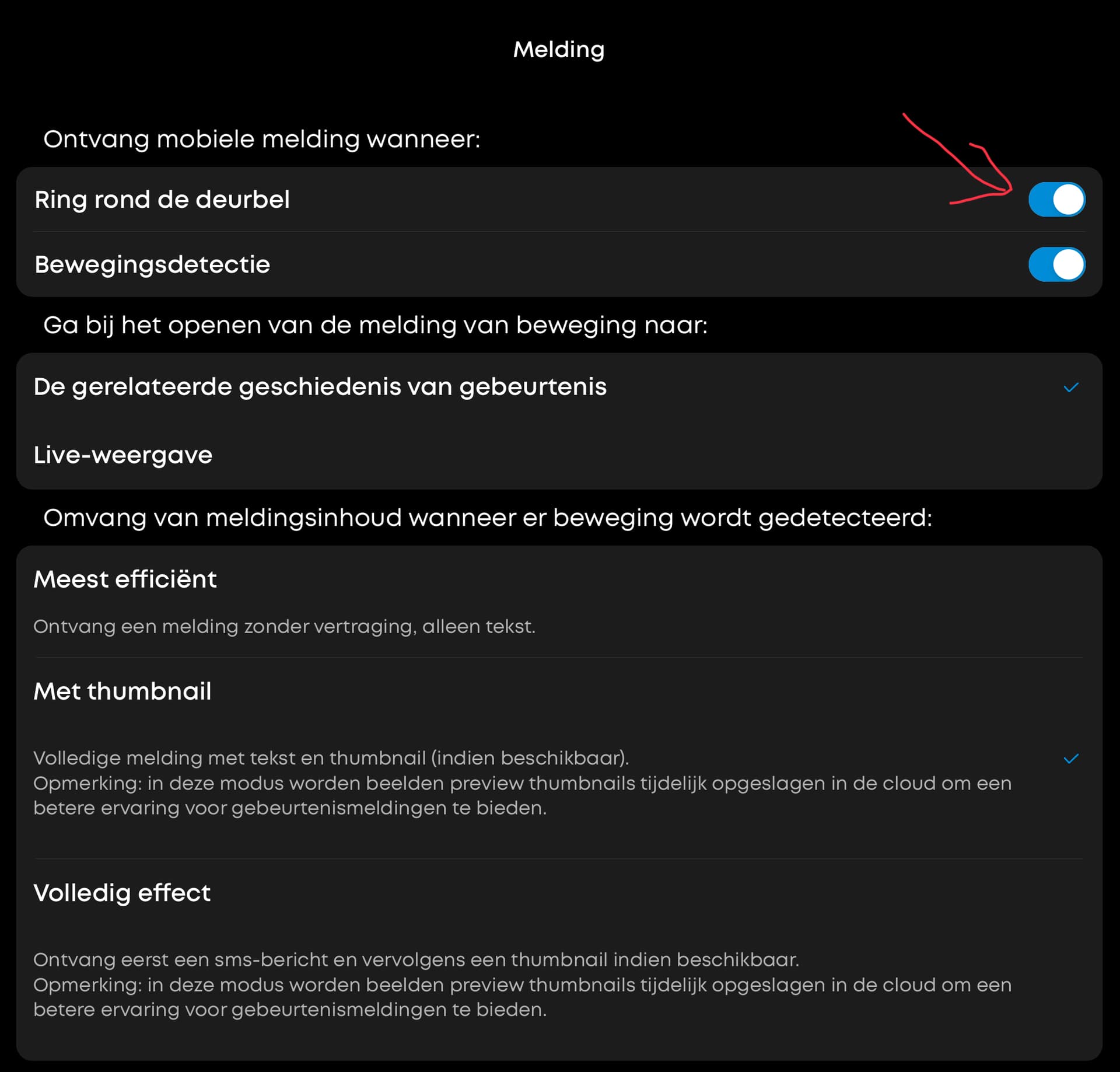

settings same as on your screenshot. changing security mode and switching cam on/off works with homey. only push not.

Hello, I just did again the test and the diagnosis directly. The first with the eufy setting of the camera which must only recognize the person, the second with only the presence of a human. In the first, no notification with my name, in the second there is the notification of human detected
Ho I forgot,I have the last test version :wink:
@Gerald_Delhaisse the person name is not in the data which is coming in.
Do you see a recognised person in the eufy app on your phone?
In the first, yes there’s a name in Eufy, the second of course not
But when eufy recognize me, there’s no notification in eufy. It’s not the problem?
Hi Martijn,
I found the problem in the settings of the Eufy.
After trying the test version, it eventually started working. What exactly the problem has been I can no longer say after having adjusted so many settings
Probably in the next setting, when on it’s working.
Misled by translation of the function
@Gerald_Delhaisse that sounds like a problem yes. Without a notification homey wouldn’t know. I would recommend to check the notification settings of your camera
@Joker glad it works!
Pfff ok i understand. I was checking many times in notifications of camera…For human recognization it’s in the homebase sttings. Sorry, it’s not your app and thanks for your patience :wink: (i hope my brain is better than google translate :smile: )
