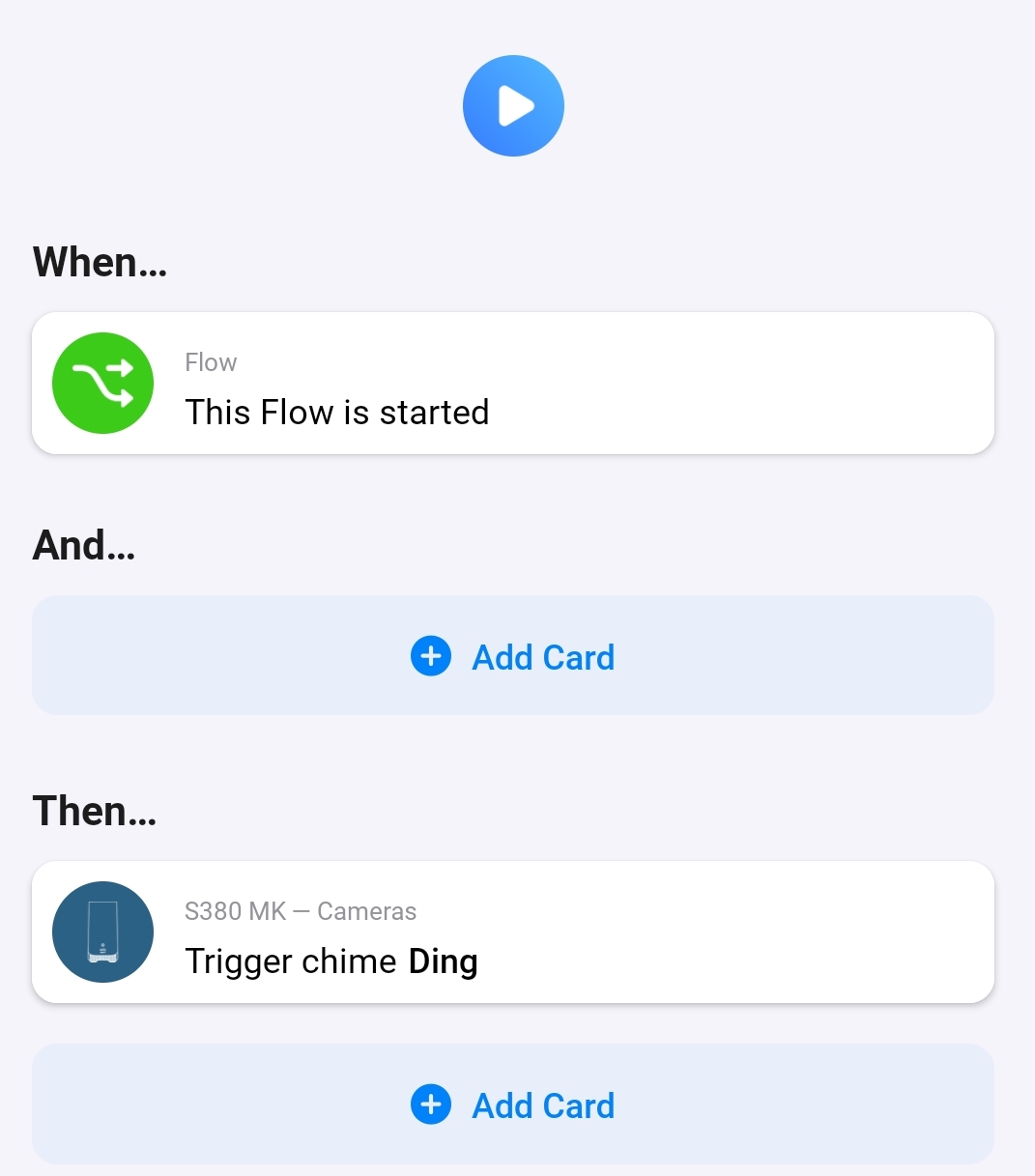

Hi Martijn,
no sound :frowning: Am I doing something wrong?
05ba9898-34ef-41cb-95a6-efb995502ac8
@Sharkys yeah sorry its kinda fixed. :stuck_out_tongue:
