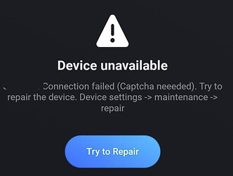

@martijnpoppen first time it fails, it reloads the page and is asking for a Recaptcha (which didn’t show on the first page load).
When also filling in the recaptcha it works.
I have an error message on the Homebase in Homey saying:
“Homebase Verbinding mislukt (Captcha vereist”
However, there is no ReCaptcha on the Eufy login page in Homey
Hi Martijn, I have strange issue - after S380 to the account, few hours later I got captcha required.
Now when I’m signing in “Homey” EUFY account, eg. on page https://mysecurity.eufylife.com, capt-cha is required every time ;-(
When trying to repair account from Homey, I got spinning wheel after entering credentials - no request to enter captcha.
I noticed we can select EU and US region, but on https://mysecurity.eufylife.com there are countries, not sure if this is somehow related ?
I think the issue is in the (Re) Captcha.
Seems to be a new security feature Eufy started to roll out.

@Sharkys @Kuijkens can you send a report.
Eu and US is country based (underwater)
Probably something goes wrong with the captcha. But its all implemented in the Homey app.
Captcha is not something new. Its already there for 6 months
@martijnpoppen I already send a report in my first message regarding the issue.
Anyway, here is another one:
c9f0899a-9bbf-4f28-a195-8f31bd852051
@Kuijkens ah sorry. But its Saturday so that means report day :face_with_peeking_eye:
Will check!
@Kuijkens i see.
Can you check the live verson of the app and see if it also doesn’t work? Eufy Security App voor Homey | Homey
I was able to perform maintenance, the captcha load took aprox. 20-30 sec but this time appeared and after another 1 min all devices went online. So indeed, test version is broken.
Diag. sent if needed.
@martijnpoppen with the live version it works.
Shows the captcha after a while and after filling it in it is able to login:
93f49021-1a8c-4977-92dd-cfdb414853bb
Found the issue will make a new version tonight :slight_smile:

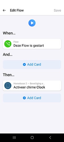

@Heula strange. I made a custom implementation inside the Homey app. Tested it with a spare homebase and it worked. Can you check if the volume is up on the Homebase? :stuck_out_tongue:
It should work as it is right now

Hi @martijnpoppen , checked the volume and that was/ is at maximum level.
This test flow runs fine but no sound is coming from the homebase 2
@Heula i’ll come back on that later. Guess i have to enabled extra debugging to check this :confused:
This worked before so strange that is doesn’t now.
Will implement some debugging later

Yes I can confirm. No chime on Homebase 3 either.
