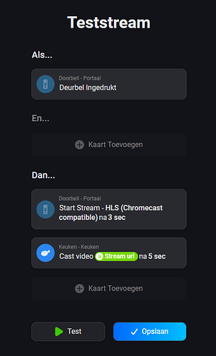

So I created a new account for Homey and added my doorbell to Homey.
I’m trying to stream my videofeed to google hub when the doorbell is pressed.
what’s the best way to get it to work?
this is my current flow but I guess I’m doing things wrong.
Hey @Davy_Bammens
Yeah there are 2 ways to do it. So yours seems fine, but you’ll have a 5 sec delay.
You can also split it up like this:
remove the cast card here :top:
And create a new flow with the following cards:
Oh and make sure to cast a webpage instead of video :wink:
thx the problem was the video instead of the webpage. I changed it and it worked. Thx for the answer.
