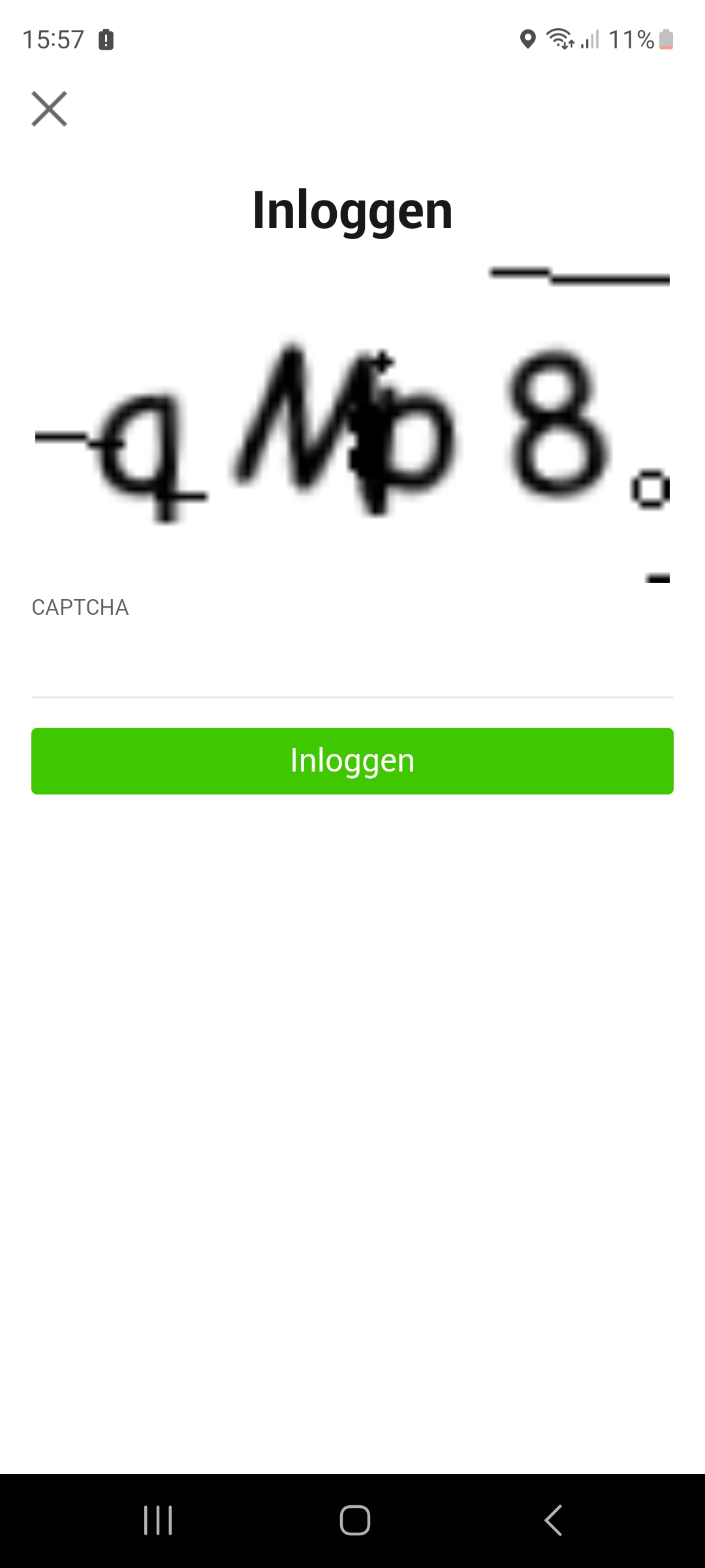

Hi @martijnpoppen
I can’t login after the update. I get a captcha but non of them will work. I add these 4 digets and nothing happens. Am I doing something wrong here?
Thanks
@Heula
  1. Are you on the test version?
  2. did you login yourself or did the app ask for it?
  3. can’t really say what is wrong with only a image, can you share a report?
I’m on the latest test version.
I saw some emails coming in with 2fa codes and than I saw Eufy was updated.
I still get the captcha digest when I do repair and login? Even after I disabled the 2fa for my second account.
After a while without doing anything all the red marks were gone and everything was okay again.
It seems to be working fine again.
Thanks.
Strange, there was a small change in the library which i also added.
Before i used a adapted version of the library which changes i made myself.
Probably that triggered the login again for you.
The 2FA and captcha are 2 different things.
If you login frequently or have updates in Homey the captcha is triggered as a extra protection (from Eufy side)
