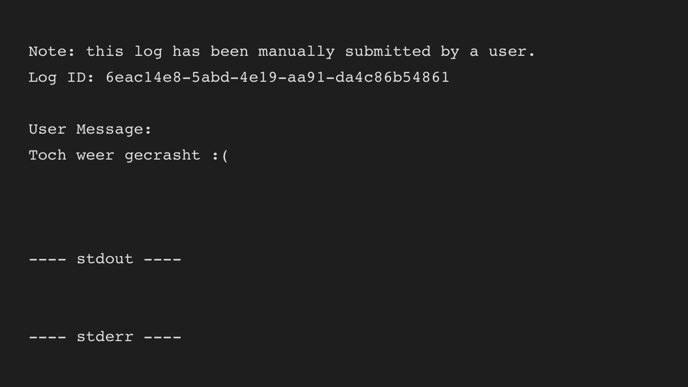

It happened again :frowning:
6eac14e8-5abd-4e19-aa91-da4c86b54861
@Edgar Again all the logs are empty,
If there’s no Exclamation mark at the app screen there’s nothing I can do to fix it :confused:
oke… then i have to live with it, until the new homey arrives :frowning:
thnx anyway!
@Edgar You might want to ask Athom if they can see what goes wrong. But from this logs I can’t see any issues:
Athom does not do anything. They just say there is an issue and i have to figure it out here… but saidly, without success so far (not only ur app). So… i will wait until the new homey and start over in that one…
Hope that fixes it :crossed_fingers:
