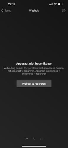

Strange ting is that the homebase is available.
But the camera’s are not. The doorbell
Is also available.
I made a log file. : e34e6ce1-fa9a-45ca-b595-7c47ae47fa2b

This is wat one camera gives :

@Yannick_Eeckelaert it seems like the Eufycam 2 Pro’s can’t find their Homebase.
Is that Homebase shared with the same account? Homebase serial ending with 225C6
Yes martijn,
I just have one homebase en it worked fine u til I got an update today. In eufy app everything works
