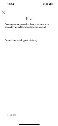

I get this error:
Can you give me some context?
Im not sure what steps you took to get there

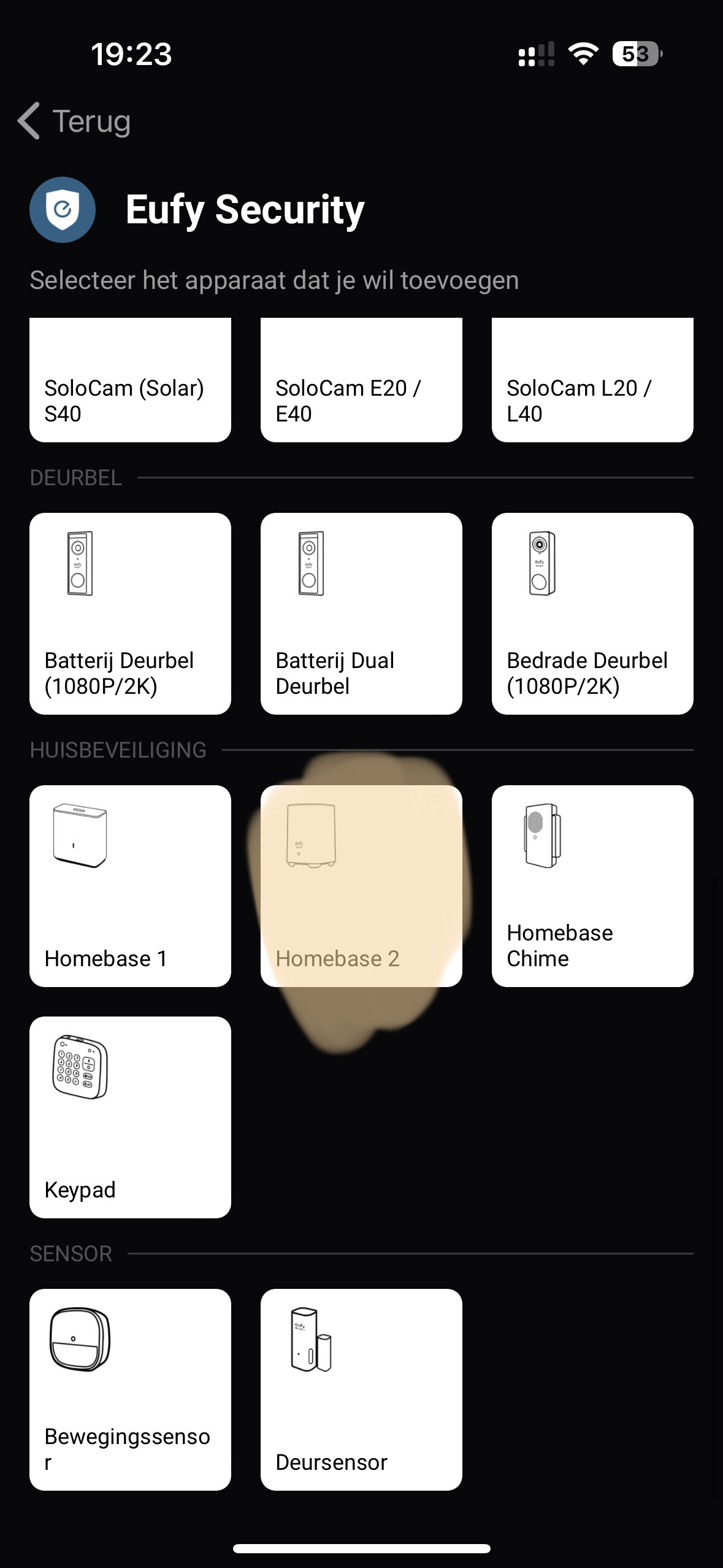

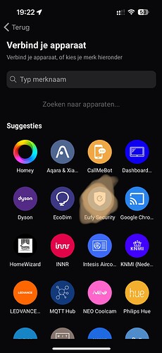

I did this steps:
Did you try a different region?
Not sure which one you selected?
I tested with both regions EU and US

@tumtum100 i see a 401 unauthorized.
So that can mean 2 things
  • Eufy locked you out.
  • login is incorrect
To verify the 2nd one try to login here: https://mysecurity.eufylife.com
If that doesn’t work your login is incorrect
Also next to that its best practice to share your devices with another account. Being logged in on 2 devices most of the time causes issues with your account
