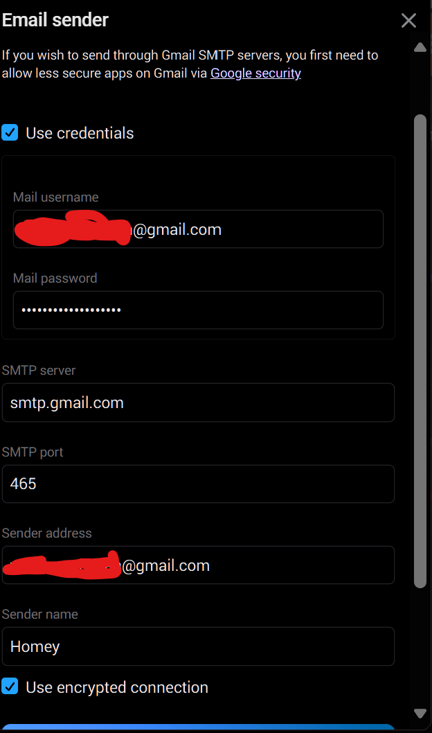

Authentication with email address and password required to continue
SMTP 408 Relay denied for your IP 83.86.xxx.xxx
Het bovenste vinkje lijkt niet aangevinkt te zijn;
Heb je na ‘test settings’ ook op ‘Save settings’ geklikt?

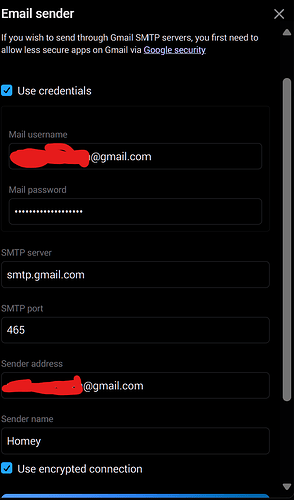

Hi guys, I tried to translate your Dutch to swedish to see if I could get Email sender to work.
But after some own research I found out how to get this to work with gmail now:
Create a new gmail adress or login to an existing email
Create an app specific password in you Goole account under - security - two factor authentification
Start configure the Email sender app
Use your complete @gmail.comgmail.comgmail.comgmail.com mail address as the username, but the app specific password
Use smtp.gmail.com as the SMTP server and SMTP port 465 (this port support SSL and the suggested 587 only supports TSL).
Restart the Email sender app in Homey.
Now it should work

Ok, but port number 587 in that reply did not work for me, but I found that port 465 is working
Dank je. Het kan wel eens veranderen in de loop der tijd.
Ik heb die post aangepast!
( mail.gmx.net bijvoorbeeld werkt nog steeds met poort 587 )
