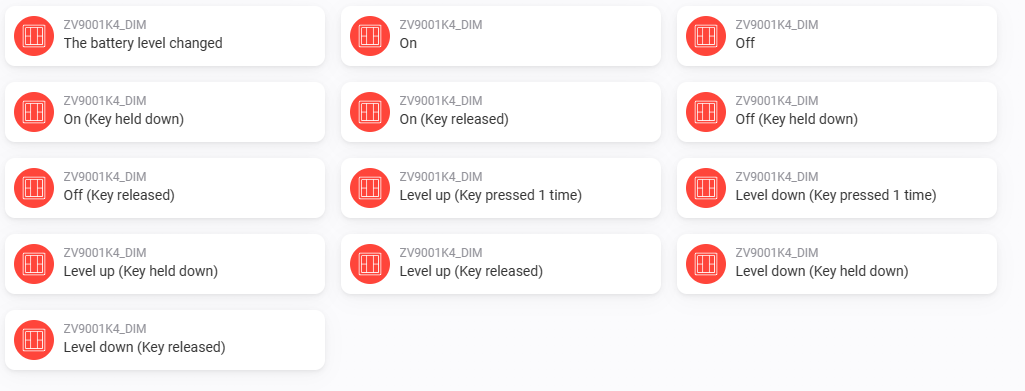

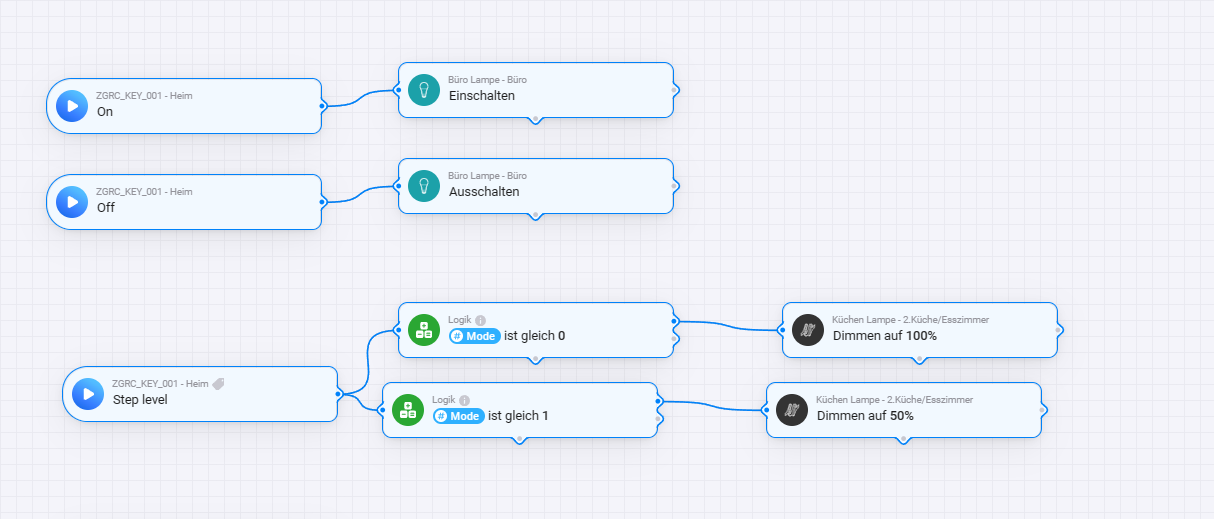

I hope this message finds you well. I am reaching out to seek your assistance regarding the integration of ZGRC_KEY_001 Zigbee devices into my automation flows.
Initially, I managed to set up the on and off functionality successfully using the provided buttons. However, I am encountering difficulties with the dimming buttons. In comparison to the Z-wave version, where the flow charts are straightforward with commands like Dimm Up, Dimm Down, Click, Hold, etc., the Zigbee version appears to only offer step-level adjustments.
In my attempts to configure the dimming buttons, it seems that mode 0 corresponds to the left dim button, and mode 1 to the right dim button (though I’m uncertain about this). The specific issue I’m facing is when I press the dim up button (mode 0), the lamp dims to 100% as expected, but then it fluctuates back to 50% and back to 100%. Strangely, I don’t encounter this issue with the mode 1 button.
Could you please provide clarification on what might have gone wrong in my configuration? Your guidance in resolving this matter would be highly appreciated.
