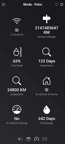

I installed MySkoda App on Homey Pro (2023), I was able to login and my car (Skoda Fabia 2022, fuel) was recognized but your app can’t get any data.
I have an active “Care Connect - Remote Access” subscription so I can see my car directly in the official MySkoda app on my smartphone.
So what’s wrong? Thanks

After I uninstalled and reinstalled your app, now it seems to communicate with Skoda server, but I get a totally wrong KM.
My car has just 5100KM, there is something wrong on “Driven mileage”.

@xazac Something is rellay off in your API data.
all data is showing mileages. on 2147483647

Does the app on your phone show the correct data?
Inside the inspection time i see 5211 which looks correct but the sent mileage is wrong again
