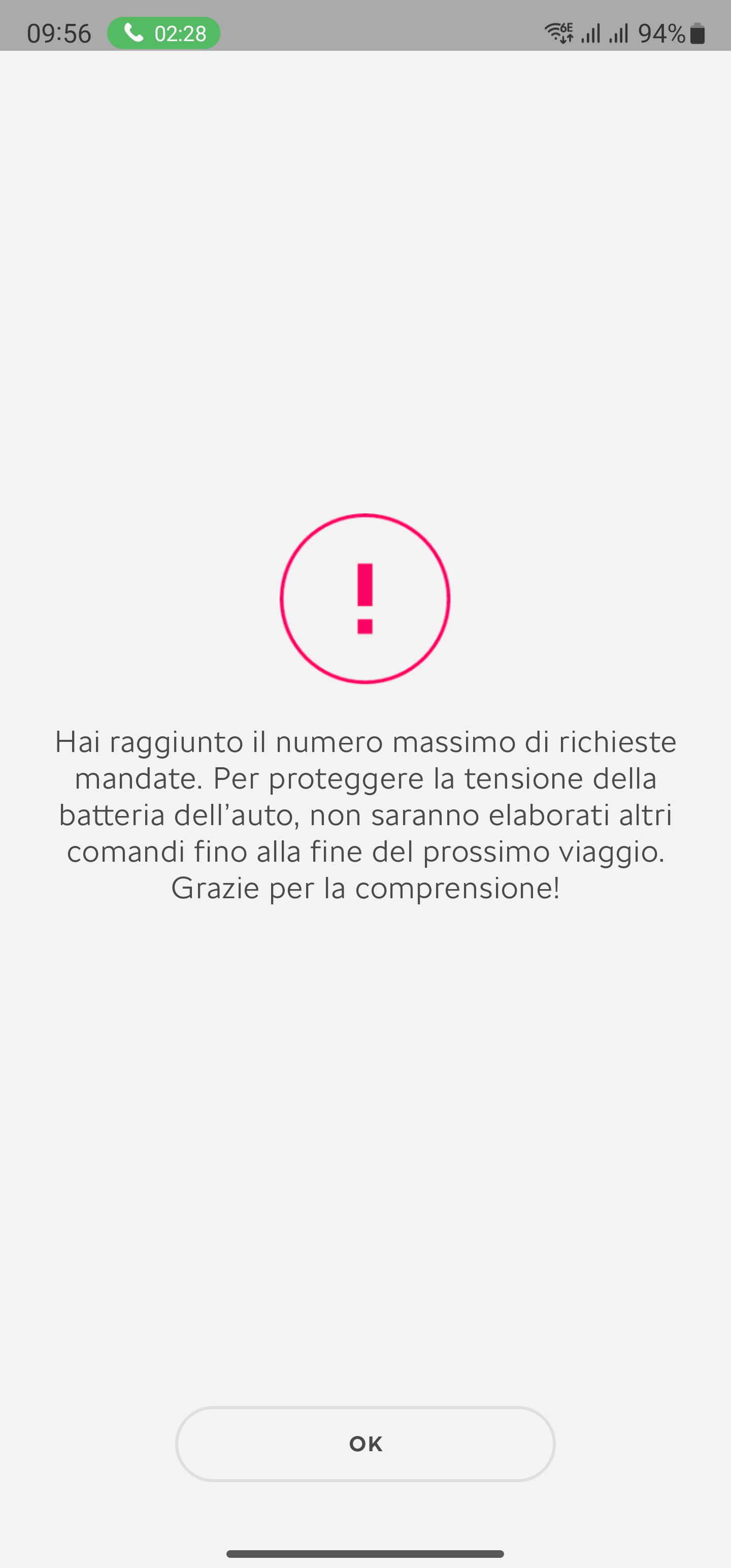

Anyway, I had to disable your plugin since Skoda Service told me that to protect car’s battery in a fuel veichle, there’s a limit about how many times you can check car status when you’re not using the car.
The reason is that at every app request the car needs power from battery to catch parameters and then send them via cellular data.
So when the car stay parked for a “long time” (usually more than two-three consecutive days), this limit is enabled automatically. Once the limit is live, I can just check the car by remote 3 times.
After the 3rd time a warning appears in the app saying the battery protection has been activated so the service will be available again at the end of the next trip:
I don’t know if you were aware of this limit, I wasn’t until yesterday!
Hey @xazac
Yes im aware of the limit and thats why the forced update is only every 6 hours. But you change the limit in the device settings.
