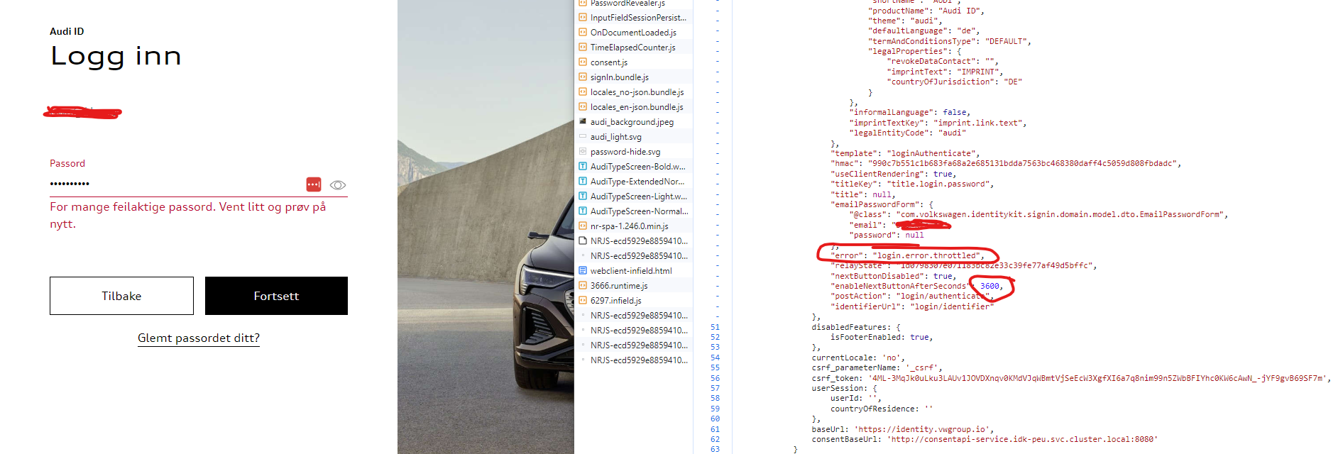

when i try to login again i get this:
when device removed and I re-add it again it also gives an error:
username and password are 100% correct

I also tried the web version of my audi, and it fails here as well, buuut I thing the real reason is this: trhotteling ? to many login attempts maybe, but for shure the passord is correct
