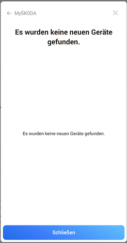

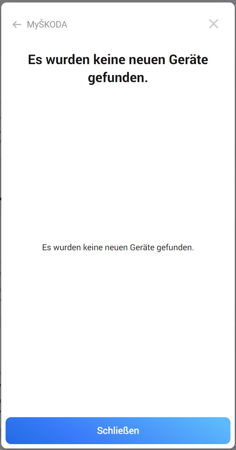

Hi, with V1.20.1 everything was fine, the app works as expected. Since the update to 1.20.3 the connection to my Skoda Hybid was lost, no new data was loaded. After reinstalling the app, I can log in to my account, but after “retrieving data” I got the message “No new devices were found”. Does anyone have the same problems?
Hey I have this same problem for my enyaq. It breaks after awhile. It will pull new data if you restart app. 1.20.3
