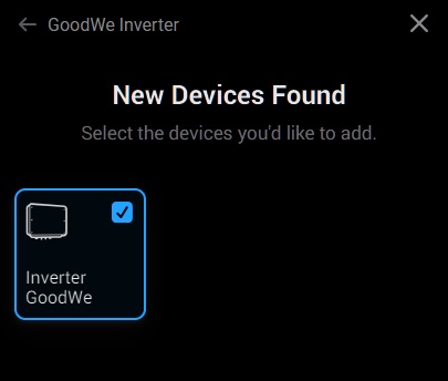

I have followed the steps, stated at GoodWe Inverter – Michal Stranik
Both modbus and cloud does not give a response.
Via cloud, I get the following error:
Device Unavailable
You have wrong login data (Username, Password, UID) or the Goodwe cloud is down.
Guess what, the password, username and ID are correct, because the Inverter is shown as new found hardware.
But with the local network, I have the IP 192.168.0.124, port 8899. I get no error, but also no data is comming. Now also the hardware was found, and checked
GoodWe
Is there something I am doing wrong?!?
