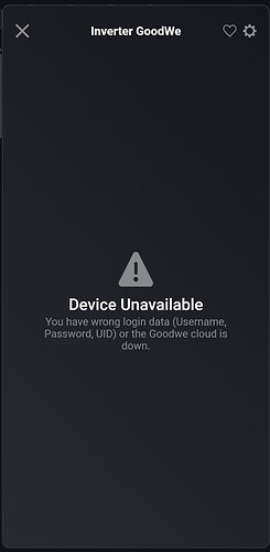

Hi @Michal_Stranik,
I’m having issues communicating to my GoodWe Inverter as per attached screenshots. System is located in Australia and perhaps the communication method varies by location?
I have triple checked my SEMS login details and the System ID as per your pairing guide. Your support link https://mistr.tech/ is not working for me to log a support ticket.
Let me know if I am missing something or if you have any suggestions.
