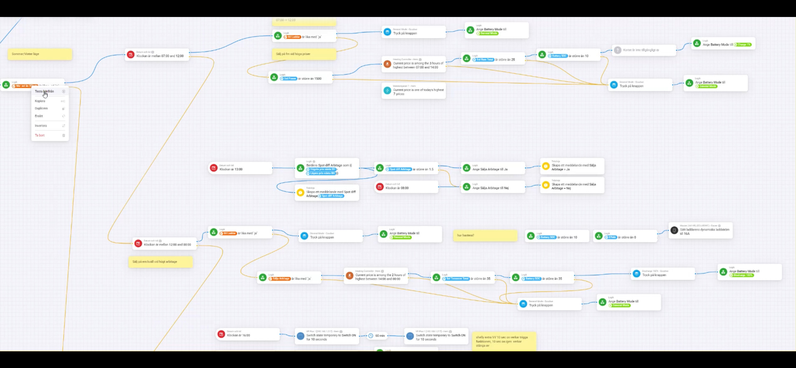

It would be helpful if could share an example flow… Thank you.

Something like this.

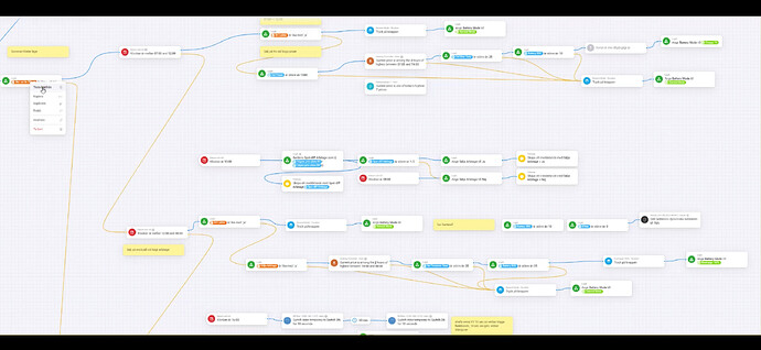

Then i control the advanced flow with virtual buttons from Home assistant.
This was a workaround…
Reached out to the developper, willing to sponsor the activity.
A dream would be to control the inverter from Homey, with “flow cards” without the need to go trough Home assistant to change modes

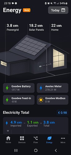

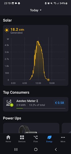

Thanks for your answer Hakan. Is it also possible to use the inverter in Homey Energy this way (as solar panels)? That’s one of my reasons that I want it in there. :slight_smile:
At the moment the only one i get up to the energy in Homey is the one i integrated from SEMS
Look here:
I am trying to add a second converter from the same plant as well but while the first one I add works fine, the second one does not connect. Does not matter of I select id 1 or 2; the first one connects, the second one does not
Check the “Exclude from energy” switch in Goodwe advanced settings. It should be “No”
I understand, but without data incoming it has nothing to add to energy. :slight_smile:
