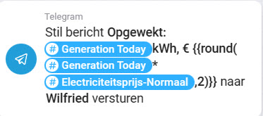

Hello Michael, thx for developing the goodwe app for Homey. I was wondering if it could be possible to add a tag Generation Today which gives the value of kWh generated today. So I can create a flow at midnight to make a notification with that value sent to me.
(Or is it already there and I didn’t see it ?)
hope to hear from you.
Kind regards, Wilfried
No need anymore. I found out that the info was in a variable.
