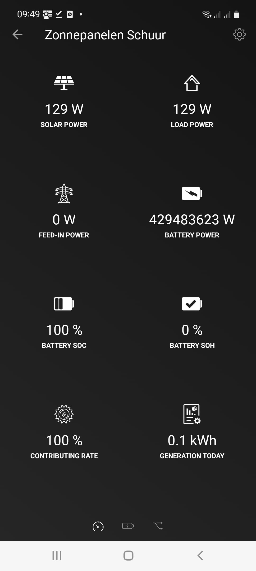

Thanks for this great app! Overall it works great, especially since the last update. I use it to monitor a small setup with a Gw2000-Xs. However, there are two minor issues that I encounter.
Is this something I can change in the settings?
