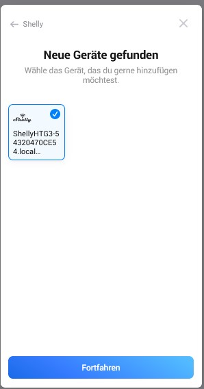

I have got a new shelly wifi humidity and temperature sensor for my Homey Pro 2023 and tried to connect it.
I used the Shelly control app to make it connect to my smarthome WLAN, update the firmware and reboot the device.
When I try to connect it with the Shelly App as Shelly any Wifi device , the Homey Pro recognises the device
But then it it telly me
An error occurred while trying to add the device. This usually happens if the device is not on the latest firmware, a battery-powered device does not remain active during pairing, or there are network issues. See the instructions in the support topic in the Community Forum. Error message: Error: The request failed because the Shelly device did not respond to the request. Network issues are sometimes resolved by restarting both Homey and Shelly devices. The request was made to http://192.168.2.64/rpc/Shelly.GetDeviceInfo

It’s right there in the pairing instructions from the first post.
- If it is a battery operated device make sure to keep it awake during pairing. This often involves repeatly pressing the wake button at an interval during the pairing process. Read the device user manual how to wake the device (usually by single pressing a button inside or a pinhole outside the device). The pairing wizard will stall with an error if you do not keep it awake correctly;
Thank you @Phuturist ,
I forgot to mention that after the first problems, I plugged in the USB C plug - so it is under constant energy - and it is not sleeping.
If you can’t connect to the built-in web server it is sleeping.
Oh thank you - obviously my understanding of the devices is still not enough. ![]()
I will try again tonight. ![]()
@Phuturist , @robertklep ,
I tried and you were right. Now it works, sorry for disturbing.
Many thanks Dirk

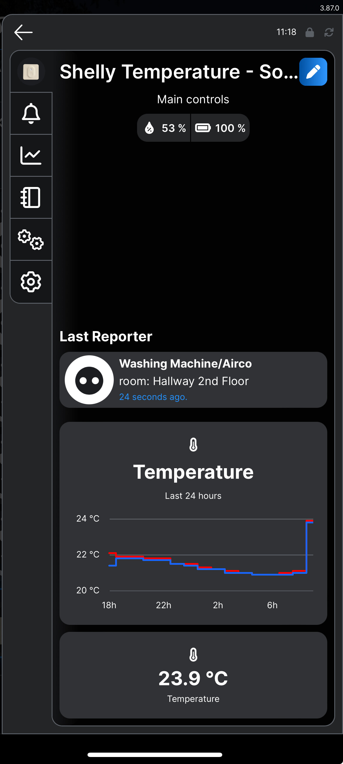

Hello, I added two new Shelly BLU HT units using the procedure you mentioned but the reading is not correct. The values, eg temperature, in the Shelly app looks correct but in the Homey Pro not. Any idea what I have done incorrectly?
Regards Jo
Please explain “not correct”.
Thanks for your reply. When I look at the temp in the Shelly app it shows 23.9 and in the homey app 26.2… see pictures.
My guess is you used the same device to connect the BLU to the cloud and to add the Homey BLE proxy script. As mentioned in the pairing instructions:
- Also be aware that the Plus/Pro device you choose to act as Bluetooth Proxy for Homey wont be able to send the status of the Shelly BLU to Shelly cloud for the mobile app as well. You will need to choose or use separate Plus/Pro devices for this.
Therefor the value you see in the Shelly app on your phone is not kept up to date anymore after you added the Homey BLE proxy script to that Plus/Pro device.
