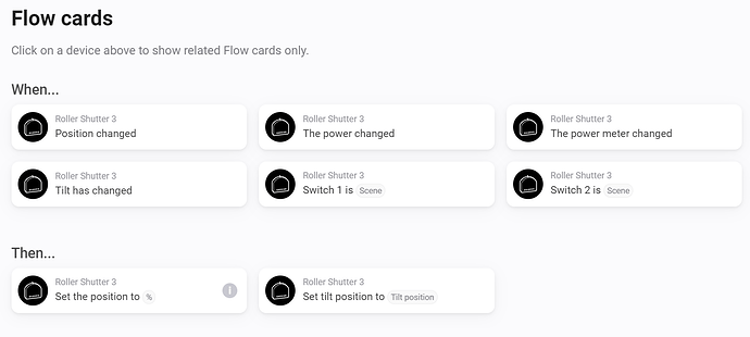

I use Fibaro Roller Shutter 3 on other blinds in my house, which can also control the slat angle.
The functionality is the same as with the Shelly Wave Shutter, but there is a flow card to control the slat angle. So it seems that the Shelly Wave Shutter in particular does not have a flow card.

Could you post the list of available flowcards. I need to contact Athom about this.
These are the available flow cards for the Shelly Wave Shutter:
These are the available flow cards for the Fibaro Roller Shutter 3:

Athom confirmed that this is indeed a custom flowcard in the Fibaro app. They didn’t explain why this isn’t a standard flowcard for this capability. I have asked this follow up question as I think this is up for Athom to solve instead of every developer having to fix that in their app. I would not even know how to do that for Zwave devices.
