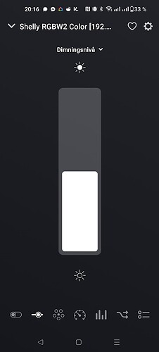

When using the “new driver” for Shelly RGBW2 its not possible to have the 4x white channels anymore. I have changed it back and forth but doesnt seems to work. Or am I doing something wrong? Using the 20231107-164128/v1.14.1-rc1-g0617c15 firmware.
Was the device configured in white mode when you paired it with Homey?
Yes, I actually used it with old driver last summer (its for gardening) in white mode. Then I removed all four devices and added new and it shows up as one device RGBW. I tried to remove and add it a couple of times with same result.
The other shelly rgbw2 that was already on new driver (it seems) is still working in white mode.
So my guess its that something in the adding process that is wrong, either by me or its a bug :slight_smile:

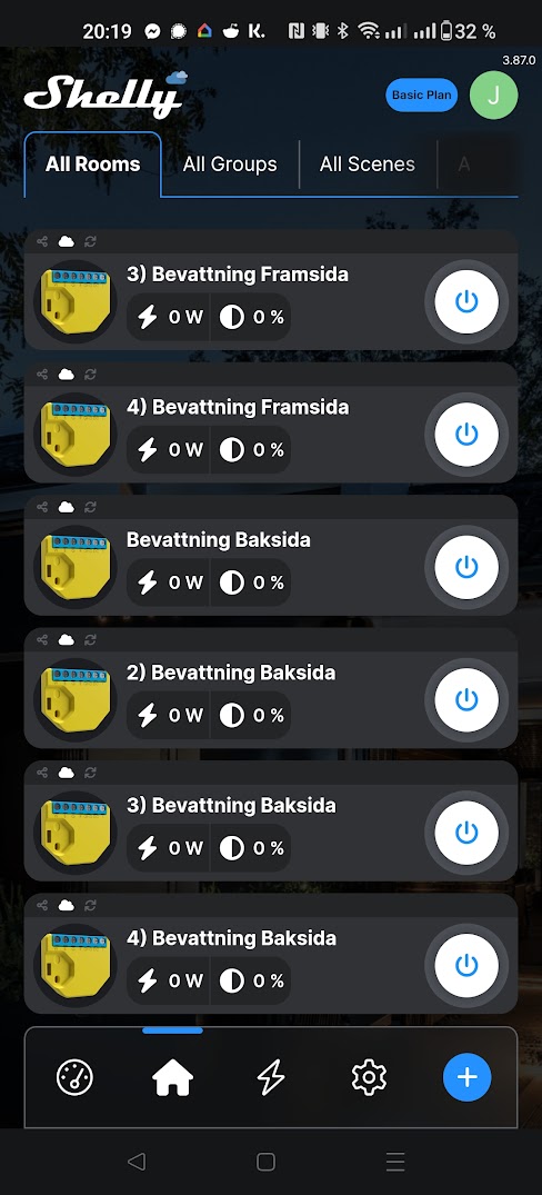

I did a factory reset, downgraded to last stable firmware. Added the device in shelly app, it shows up as 4 devices.
Then add it without authentification to homey, and it shows up as one device with a color wheel.
Any idea what I could be doing wrong?
