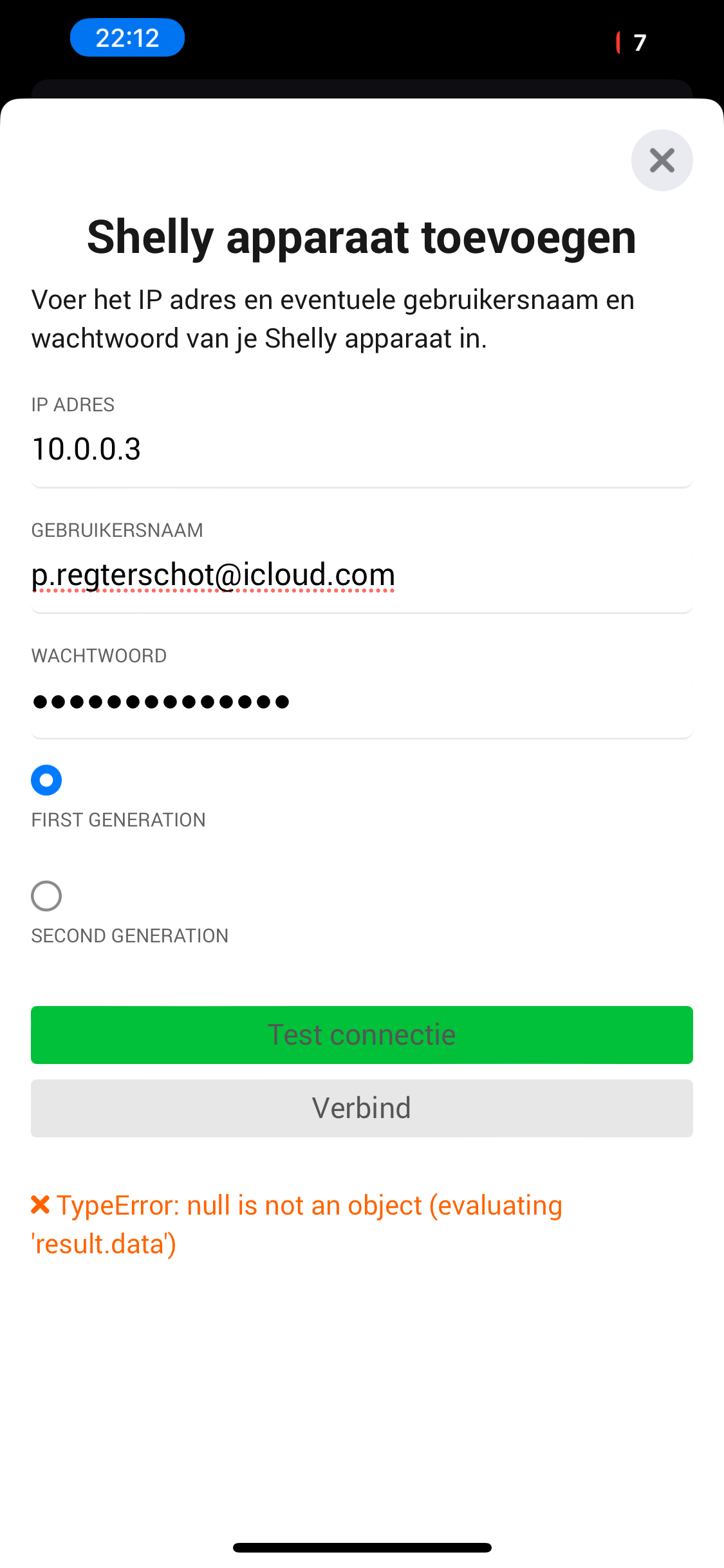

Hello , can anyone help me please finding out what the problem is with not finding my shelly device? I have two shelly em 2.5 and one shelly 3EM. I did use the two shelly s 2.5 for a ling time now but the connection was lost. Also adding a new shelly 3EM to homey was not working. In the shelly app no problem but in th ehomey app i get this message null is not an object (see picture).
I thougth it was bevause of my strange ip adres of the router 10.0.0.1 i change that in a more notmal one 192.1xx.x.x. Then i was able to add all the device s but i had connect the clamps of the shelly em3 in the wrong direction so i was getting negative power messuring. I changed the clamps and look in shelly app now the power was ok in the right direction. But in homey was still negative so i did remove the product and wanna add it again. Now i get the same issue again with errordata: null is not an object.
Can anyone help me please or does anyone has this problem before?

If your devices are not discovered and you need to add them manually there is something wrong with your network. Homey should be able to discover them over mDNS. Adding through IP address is only for advanced users. Seeying you are trying to enter your cloud details in the device authentication login you dont struck me as an advanced user. You really need to fix your networking issue and make sure Homey can reach your Shellies in the same network.
