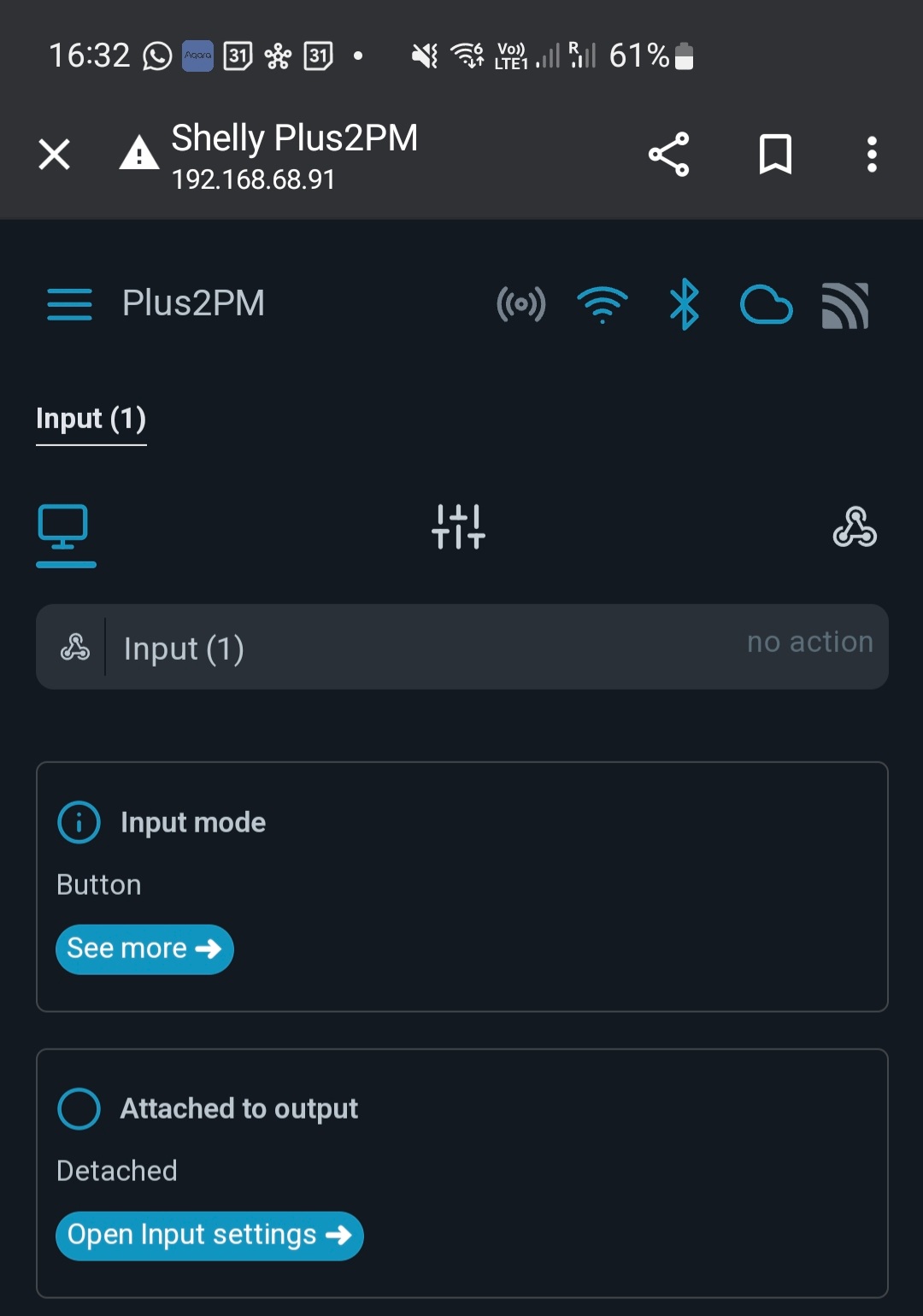

  1. Shelly is in detached mode, with button type switch
  2. My switch is a momentary switch so when i press it i get this

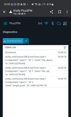

Now this is great, but the problem is in turning the lights off. I was exploring changing the light switch type to a button as per below
This would then generate the following when pushed
I was thinking to use this shelly setup with a flow such as this, so that i can do a single press for on and a long press for off. However the below flow is not working, when i press the button nothing happens with hue despitw as per above shelly is sending a message.

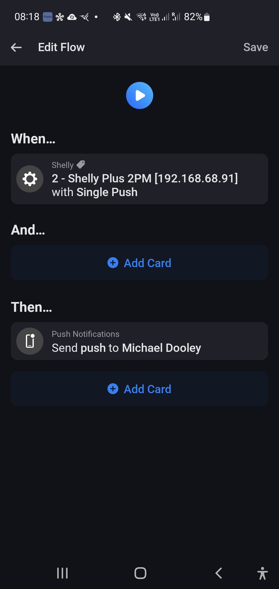

I also created a flow to test if the single push was being picked up by homey. The flow was as per below
As you can imagine i did not get a push notification.

What kind of switch do you have attached. For the action events to work properly in button mode you would need a momentary switch attached. According to the log it’s only sending btn_up and btn_down events and not a single push event.
I never implemented the btn_down and btn_up action events as a specific action event as it’s usually doubled by the input or relay. But it seems you found yourself a use case where you can solely rely on btn_down and btn_up events. I might consider adding them but I’d like to know if you are using a momentary switch or a regular toggle switch for this.

I’d have to investigate this, perhaps there is something wrong with the triggering of action events on multichannel Plus/Pro devices. Got another user that reported a similar issue with a Pro 4PM.

It’s a bug. A fix should be up in an hour or so.
[EDIT] And it’s up.
Tested and working great, many thanks!!:grin:
