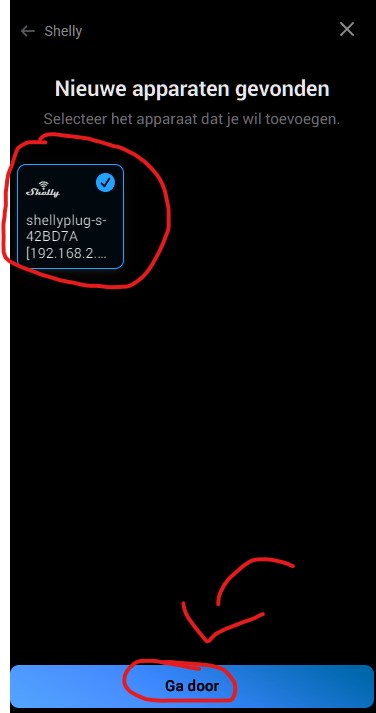

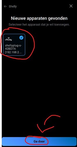

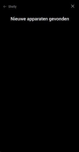

It seems like my device is broken. It always worked but since yesterday it suddenly can’t reach the host device. IP adres of the device is still the same and I can control it through the Shelly app.
So I thought let me delete the Shelly Plug device from Homey. Now I can’'t add it anymore. I can select the device to install and press “Ga door”. Afterwards I get a blank screen and nothing happens for half an hour. See screenshot.
I already tried reinstalling the app (install after restart homey) and I tried on webbrowser and on phone.
Is this a bug?

Maybe scroll up?
Read the first post of this thread.
Here we go again. No it’s not. From the first post:
Users often blame the app when things are not working as expected but most of the time the issue is related to their own actions and/or configuration and not following the instructions posted here.
