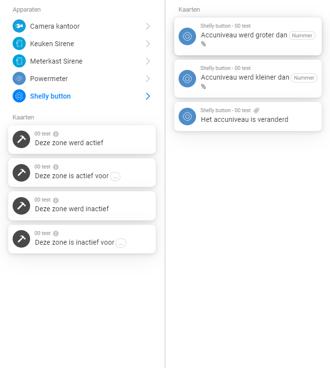

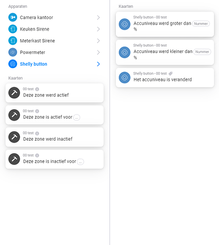

No flow was made yet since pairing because there are only battery flow cards, no button flow cards. I would expect flow cards something like “buton is short pushed” or “button is long pushed”. I’m I doing it wrong?
Below a screenshot of the available cards:
By the way, the battery vallue is now 100% so indeed, it updates when changed, it took 3 days dough. Signal vallue is still empty but that will change later on I suppose.

Please explain. Looking at screenshots without context gets me nowhere.
Right, will fix that with the next release. But more important, is the mechanism working now?
I got it working. It is completely different then before with other Shelly’s. Why is it made like this?

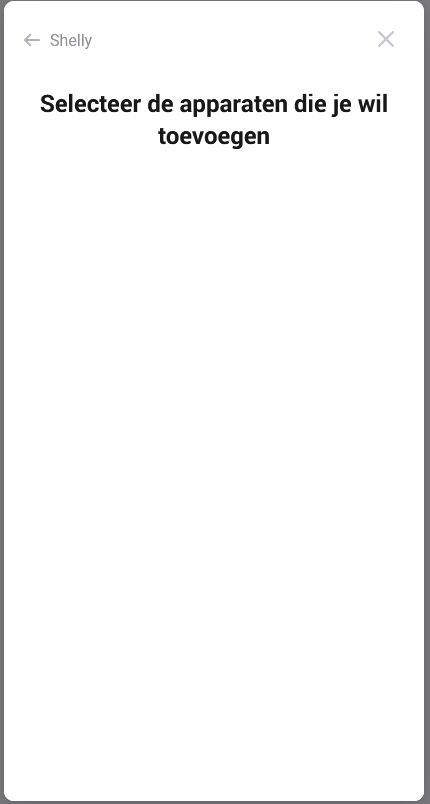

I just purchased a shelly 2PM plus. I managed to install it in the Shelly app an the roller shutter is working perfectly from the Shelly App. now I want to add it to the Homey Pro 2023 but can’t add itfollowing happens:
I select Elk Shelly Wifi apparaat
I select verbinden
I select Ga door
Again I select Ga door and receive this following screen
and this stays.
Any help is welcome
The Wave 1 is already fully supported. The Wave 1PM is missing energy / power capabilities due to an unidentified issue, possibly something Athom needs to solve.
Read the pairing instructions from the first post.
