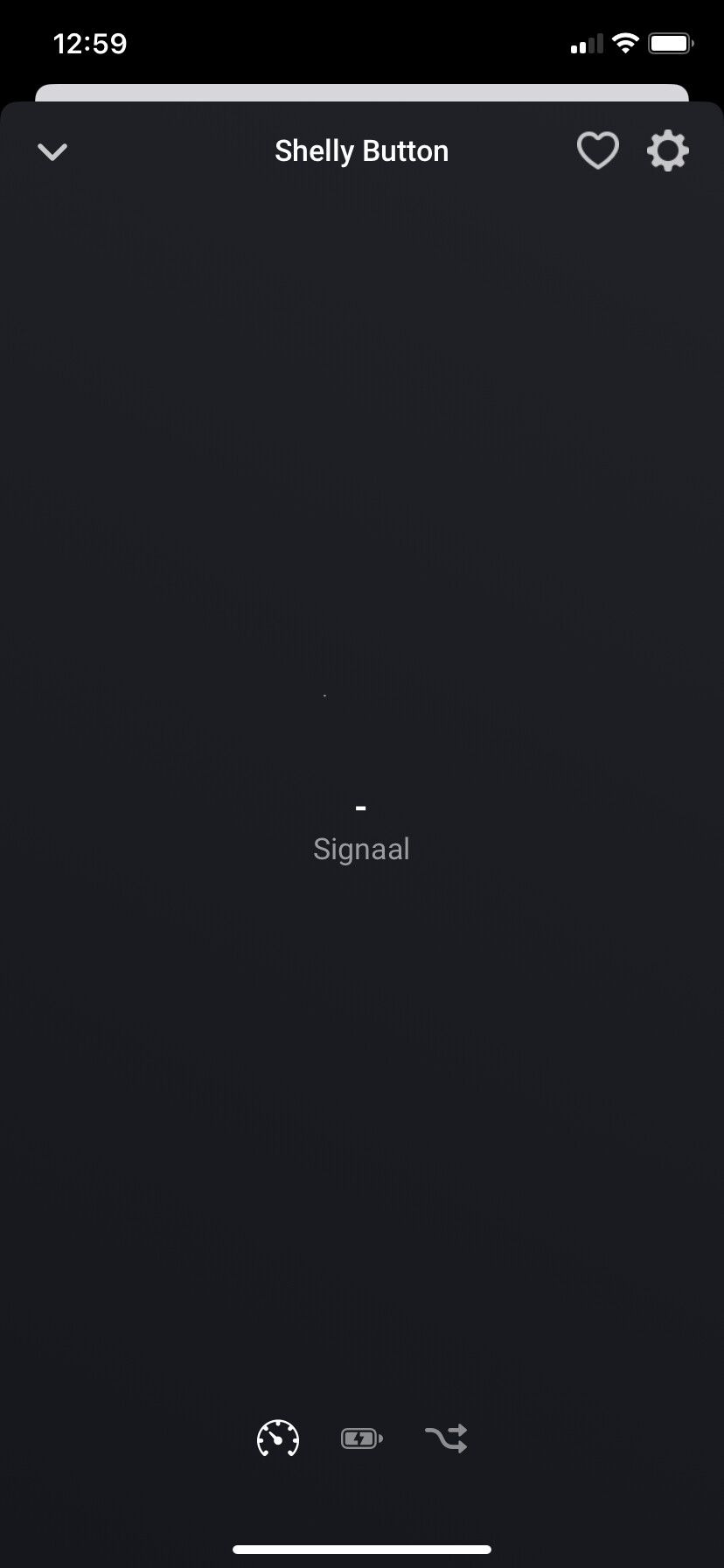

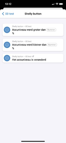

I recently purchased a Shelly Button 1. I could configure it perfectly like all my other Shellyâs, it also connected easily with Homey. However, no signal is received, no battery information is shown but worse, no button actions can be picked-up in a flow.
Any idea what is wrong? Maybe I have found a bug?
Please see below some screenshots:
Hope you are able to help.

Hi Robert, I double checked, but all steps are walked trough. It is not that Homey is not communicating with it, there is simply no information from the button reaching Homey and flow cards seem to be missing. All my other 36 Shelly devices work perfectly but none of them are a shelly button.

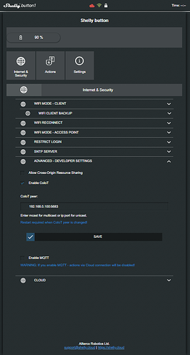

Could you post a screenshot from the settings as described under step two of the mentioned troubleshoot guide.
Hi Phuturist,
Please see below:
I noticed that the time is not there as well, my other Shelly devices give the current time like it should be. Battery is on charge for like 2 days now and still says 90%. Could there be something wrong with the firmware for this specific Shelly or maybe a malfunctioning product?

Signal and battery only change when updated. If they havenât changed yet since pairing nu value is shown. Could you post your flow.
