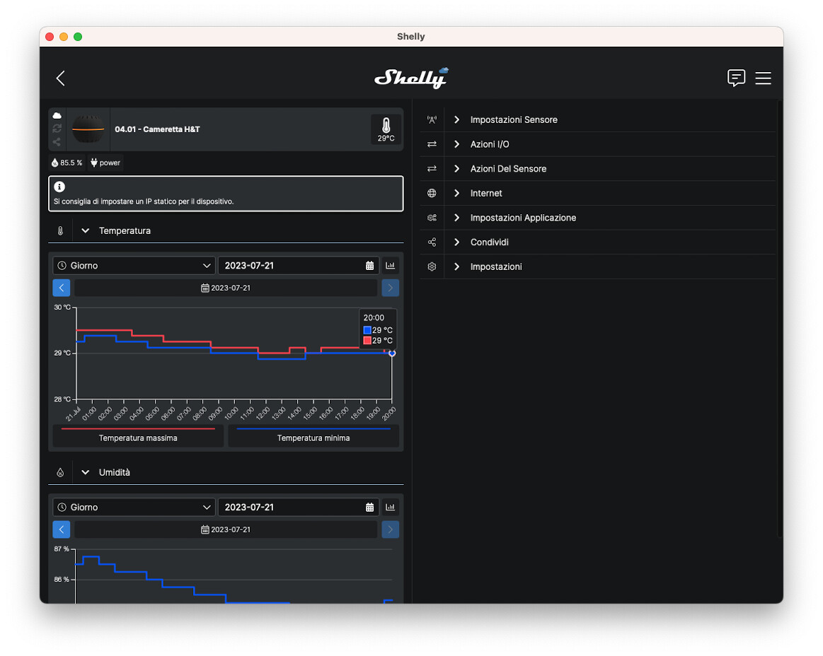

Dear Phuturist,
I haven’t been able to answer you before.
Yesterday evening, shortly after 20:00, I made the screeshots that you can see below; I divide them into 4 groups and then I give you the Settings and Status of the 4 Shelly H&T that I remind you are powered externally via Micro-USB cable
– 1Āŗ – 02.01 - Sala H&T
In the Shelly App the update dates back to 20:00 and can be considered correct, in Homey Pro the update dates back to 2 days before and obviously cannot be considered updated.
– 2Āŗ – 03.01 - Camera da letto H&T
In the Shelly App the update dates back to 20:00 and can be considered correct, in Homey Pro the update dates back to 3 days before and obviously cannot be considered updated.
– 3Āŗ – 04.01 - Cameretta H&T
In the Shelly App the update dates back to 20:00 and can be considered correct, in Homey Pro the update dates back to 19 minutes and therefore can be considered correct.
It’s the furthest device from the Mesh bases and Homey Pro, strange but true…
– 4Āŗ – 05.01 - Bagno H&T
In the Shelly App the update dates back to 20:00 and can be considered correct, in Homey Pro the update dates back to 22 minutes before and therefore can be considered correct.
It is not very close to the Mesh base and Homey Pro.
These are instead the Settings and the Status of the devices:

The two Shelly H&Ts that respond less, or do not respond, are the ones closest to the primary node of the Wi-Fi Mesh network and to Homey Pro.
I ask you some curiosities:
  • Can the offset values of Humidity and temperature affect the number of device updates?
  • Is it possible to write a Flow – if so, how – that wakes up Shelly H&T every ā€œXā€ minutes?
If I have not been clear in some point, feel free to ask me for explanations.
Many thanks, see you soon!
You are wasting my time. How many people told you to follow the troubleshooting guide from the first post. You obviously just keep on ignoring this advice while you could have fixed your issue days ago and save you hours of grinding a Sharpie. So to quote you, ā€œFOR THE UMPTEENTH TIMEā€, follow the advice that is given you.
  • 02.01 Sala H&T / .152: it’s missing the peer address of Homey under the CoIoT settings, see troubleshooting guide step 2.
  • 03.01 - Camera da letto H&T / .164: the temperature in Homey is the same as the device, it wont update the temperature if it hasnt changed. Put it in the fridge and you will see if sends changed values after you take it out.
