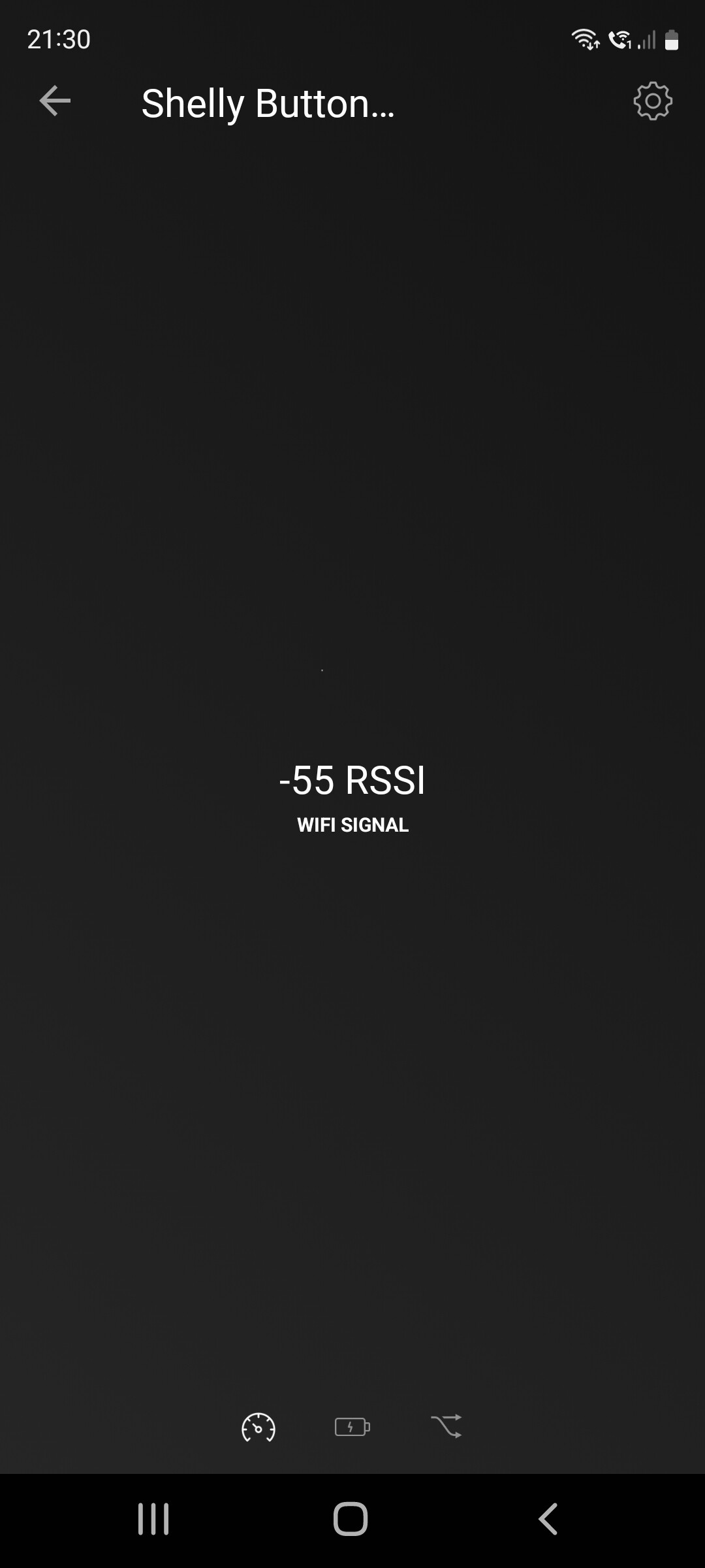

I bought a shelly button 1.
If i like to add it tomy homey pro it adds the device but seems not to recognize it and add it correctly.
After adding there are no actions available.
Any one experience the same issue? Any solution?
Thanks
There is a trigger card under the app (not the device) which you can use.
