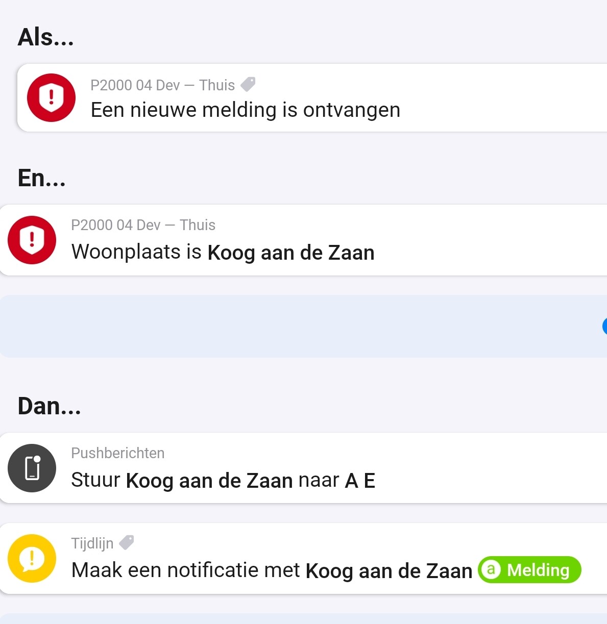

Also noticed when I put only my city Koog aan de zaan I didn’t receive the messages
This one was a few minutes ago but no messages
Can you screenshot your flow?
Tested Koog aan de Zaan.
Don’t know if this are all the messages.

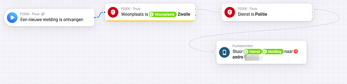

Maybe oob issue?
but when i test the flow only the yellow line is active,
test on
Homey 2023pro
P2000 app: 4.1.0
@andre_ZWL in adanced flow you can’t input all parameters, so it gives an orange line. In a normal flow you can :man_shrugging:
Like this:
aha oke thats the issue, sorry did not know that
No worries :stuck_out_tongue:
I already reported it at Athom, seems like a AF issue :0
hope they fix it soon :slight_smile:
@andre_ZWL but your flow will probably not run :wink:
In your condition you have Woonplaats tag and Zwolle, so that will always fail
indeed it :frowning: what can i beter do ?
@andre_ZWL just only fill in “Zwolle”
Delete tag woonplaats. Fill in only Zwolle
stil same error:
@andre_ZWL did you fill Zwolle as Woonplaats? during the test? Like in the inputs?
