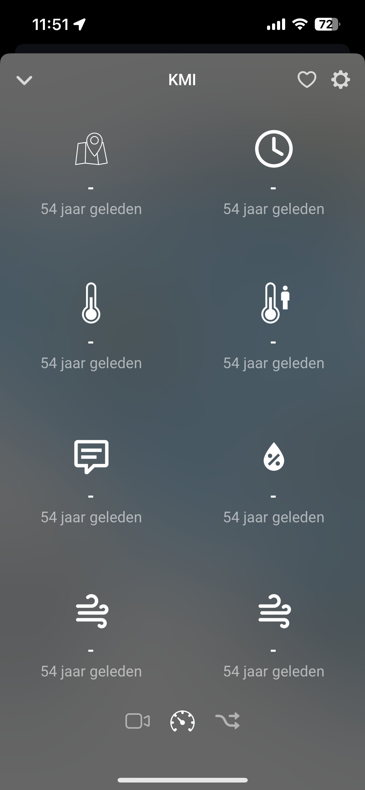

Solved!
Thanks to https://community.homey.app/t/timeout-adding-devices/111351
Apart of having problems with KNMI / KMI I encountered the same problems with Google Sheets and Withings. Did a restart of my ISP modem (Telenet), the IPv6 of HP changed and everything works again!

Restarting the modem solved my problem but I 'm sure I’ll encounter the same problem again.
At least now I know how to solve it.

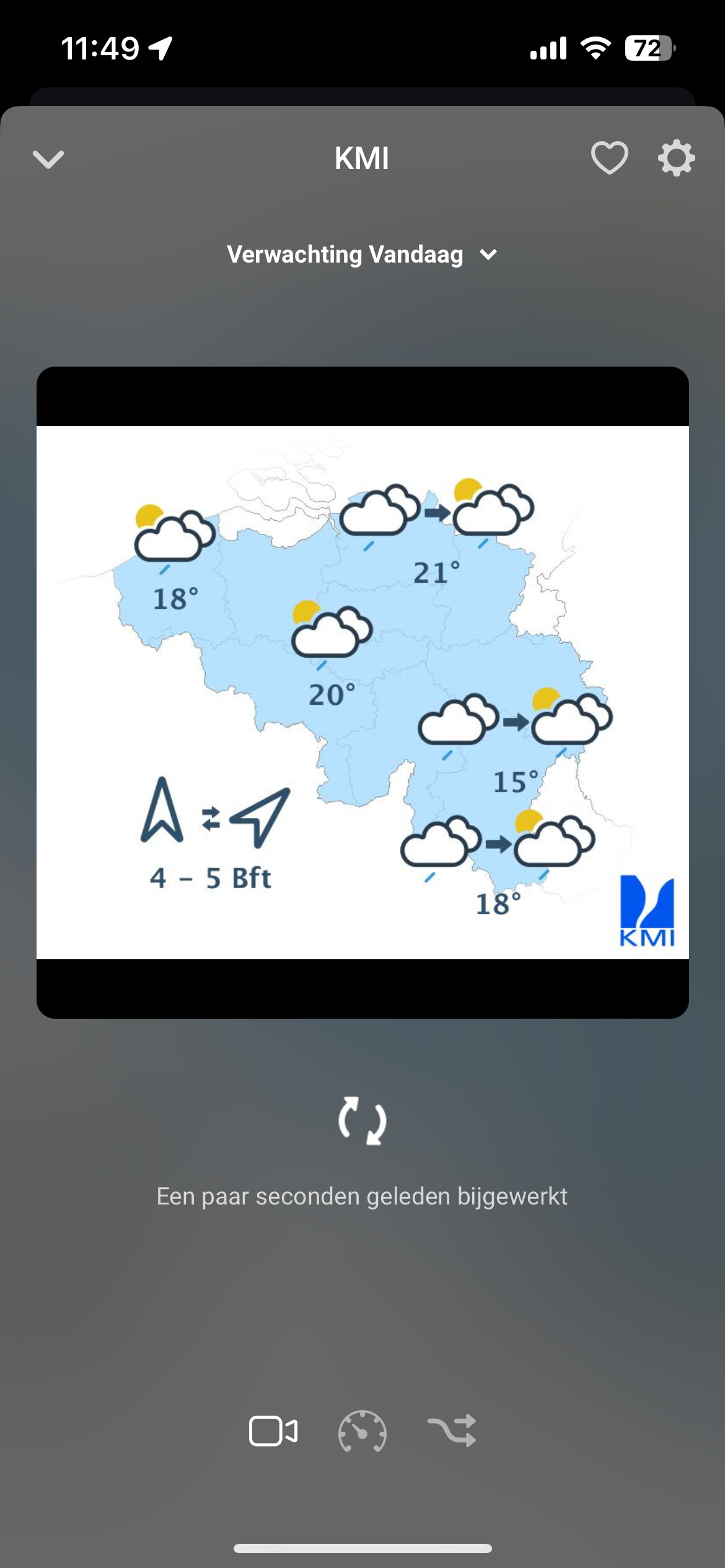

Hello Rob, and Martijn thanks for all the effort so far. I’ve got the Homey Pro 2023 and installed your app. I do receive the 10min observated data. As for the forecasted (expected) data, when and how many times per day does it get updated? I struggle to get the latest today. I’am pretty confident that by now (10am on Sunday morning) the forecasted data for today should be present. I tested ‘Fetch new data’, but for example the forecast max temp for today (around 25 degrees) remains 21 degrees, which is the forecast for yesterday (Saturday). Also many other variables are relatively old (5-48 hours). What do I wrong?

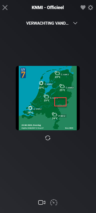

Hi Leon, sorry for the mistake in your first name. Thanks for your answer, so the update-frequency does not seem to be the issue. As Bram, several variables are old, (some even days indeed). Please compare screenshots below, the maximum temperature in map reads about 25-26 degrees (near Arnhem where I live). The forecast max temp today in list of variables reads 23 degrees. Those should match right?
To add on it to hopefully finding a solution, it is just after midnight, when I compare the minimum and maximum temperature, these are the same. Of course this can occur (rarely), but 18 degrees as a maximum temperature for Tuesday is not very likely. See screenshot below. How can this occur?

Just a clarification, the images come directly from the KNMI website (and will not be up to date every sec) and the data from the app via KNMI to Weerlive with an API to the app. So the app shows values it receives every 10min from Weerlive’s API.
