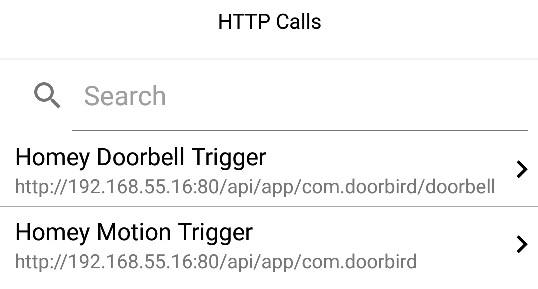

Did you setup the HTTP call notifications in the DoorBird app as described in the app store installation description.
After these steps or when added a DoorBird for the first time follow these steps (make sure you have added your DoorBird as device within Homey using a user with API-operator permissions):
  • Go to the DoorBird general settings within Homey under the settings section.
  • Click the button to add the HTTP notication URL’s and wait for the succesfull confirmation
  • If you want to use the door open / relay trigger card also click the button to schedule the relay trigger event
  • Open the DoorBird smartphone app, go to the administration area and select the ‘3D motion sensor settings’ option
  • Set the pause between alarm option to your preference (during the period no new events will be send to Homey)
  • After that select the the ‘Schedule for actions’ option
  • On this page select ‘HTTP calls’ from the top left icon pull down and select ‘Homey Motion Trigger’ from the top middle menu and click op the top left menu to fill the schedule (or configure it to your preference, this determines when the DoorBird will send motion events to Homey)
  • Go back twice and select the option ‘Relays’ and then the option ‘Schedule’
  • On this page select ‘HTTP calls’ from the top left icon pull down and select ‘Homey Relay Trigger’ from the top middle menu and click op the top left menu to fill the schedule (or configure it to your preference, this determines when the DoorBird will send door open events to Homey)
  • Go back twice and select the option ‘Schedule for doorbell’
  • On this page select ‘HTTP calls’ from the top left icon pull down and select ‘Homey Doorbell Trigger’ from the top middle menu and click op the top left menu to fill the schedule (or configure it to your preference, this determines when the DoorBird will send doorbell events to Homey)
  • Test your settings, everything should be setup now to receive events from your DoorBird within Homey
Stom used to have an old doorbird and there was no schedule in it.
Dank je Fijn weekend
I have one flow starting with the card “Aangebeld” ant this is working great!
When i enable movement in de doorbird i also get these messages by this flow, so when there is movement the “Aangebeld” flow is triggerd. The Http messages are set by the app. What could be the problem here? THX!
You have not followed the instructions to the letter and have probably connected the doorbell http call to the motion event in the DoorBird smartphone app. You should check that.
