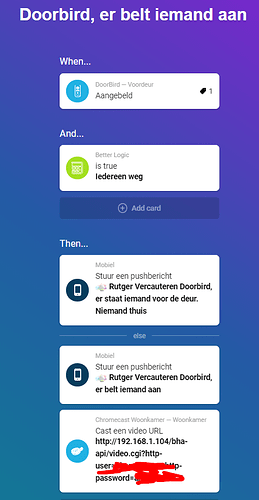

Just wanted to comment about V2.0. I have a flow to send stream to chromecast on doorbell ring. Yesterday I’ve switched to 2.0, all working still like it was before. I do not have anything other then this so I can tell only for above mentioned actions and notification.

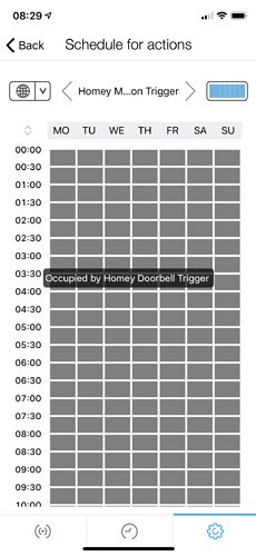

Think I figured out the last question. You cannot seem to schedule the motion trigger to the motion http call since he says it is already in use by the doorbell http call
Have you selected the right HTTP call when you try to setup the schedule for motion trigger? Make sure to select the doorbell HTTP call under doorbell schedule and motion HTTP call under motion schedule.
The double triggering is something I can not explain. Do you perhaps have the motion schedule event setup to trigger the doorbell HTTP call?
But the problem is I cannot seem to do this, I select the schedule for the doorbell trigger and when I then go to the motion schedule and select the HTTP Call motion the Doorbird app says the schedule is “Occupied by Homey Doorbell Trigger” (see picture).
Then you first have to select the Homey Doorbell Trigger there and clear the schedule (make white). It will then become available to fill with the motion http call (make blue).
Thanks! it works now…
Also found the double trigger on doorbell press, seemed the schedule for relay was on, for the doorbell http call as well.
Thanks for your help, very happy with the integration!
@David_K
I used your example but it does not work op my tv.
There is something happening op the chrome-cast but no video.
When opening the link in a browser there is video from the doorbird.
Can you see wat is wrong?
THX!!!
@cautje Try to cast a web site not a video. It should work. Video didn’t work also for me.
