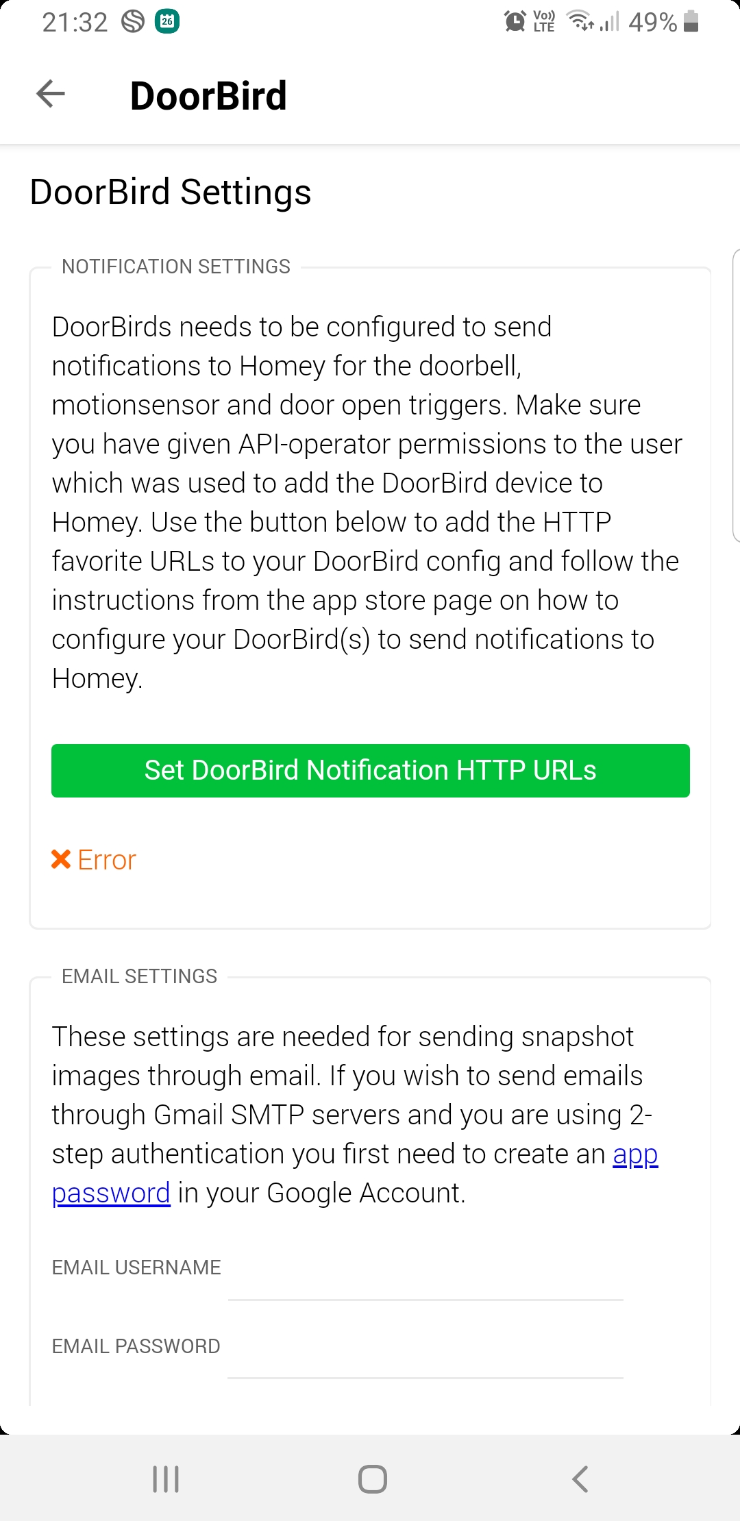

Yes, I checked the HTTP calls, and they are not set.
The error is:
Error.

I have the same problem as @Olek “Error”!
I entered the HTTP: // commands by hand and set everything in the DoorBird app. But nothing works. The Doorbird is connected and also shows the snapshot.
Maybe someone can help?

I also experience some problems. At first I couldnt register the doorbird itself using a newly created doorbird user with the required api permissions (all permissions checked). The homey doorbird app kept telling me there was an unknown error while trying to connect (and hinting: are you sure the device is on the same network as the Homey?). I did reboot the Homey and Doorbird to no avail. Next day I couldnt give up and suddenly the connection was successfull (after creating and removing about 5 doorbird api users trying to use them one by one?).
Now that the Doorbird device is finally added to the Homey app registering the http calls using the green button also fails. It just says “Error”. So I have added the mentioned http calls manually (as mentioned by Phuturist), assigned the schedule in the native Doorbird app but not a single event seems to arrive at Homey (native Doorbird app still works as expected).

So we went back to our office (which has a working Doorbird + Homey) to try. Remove doorbird from Homey (we backup the HTTP strings in the doorbird app before deleting) and added the doorbird to homey from scratch. Same thing happened, Set DoodBird Notification HTTP URLs reported error but we can see camera snapshot. The same user with API operator didn’t work!
