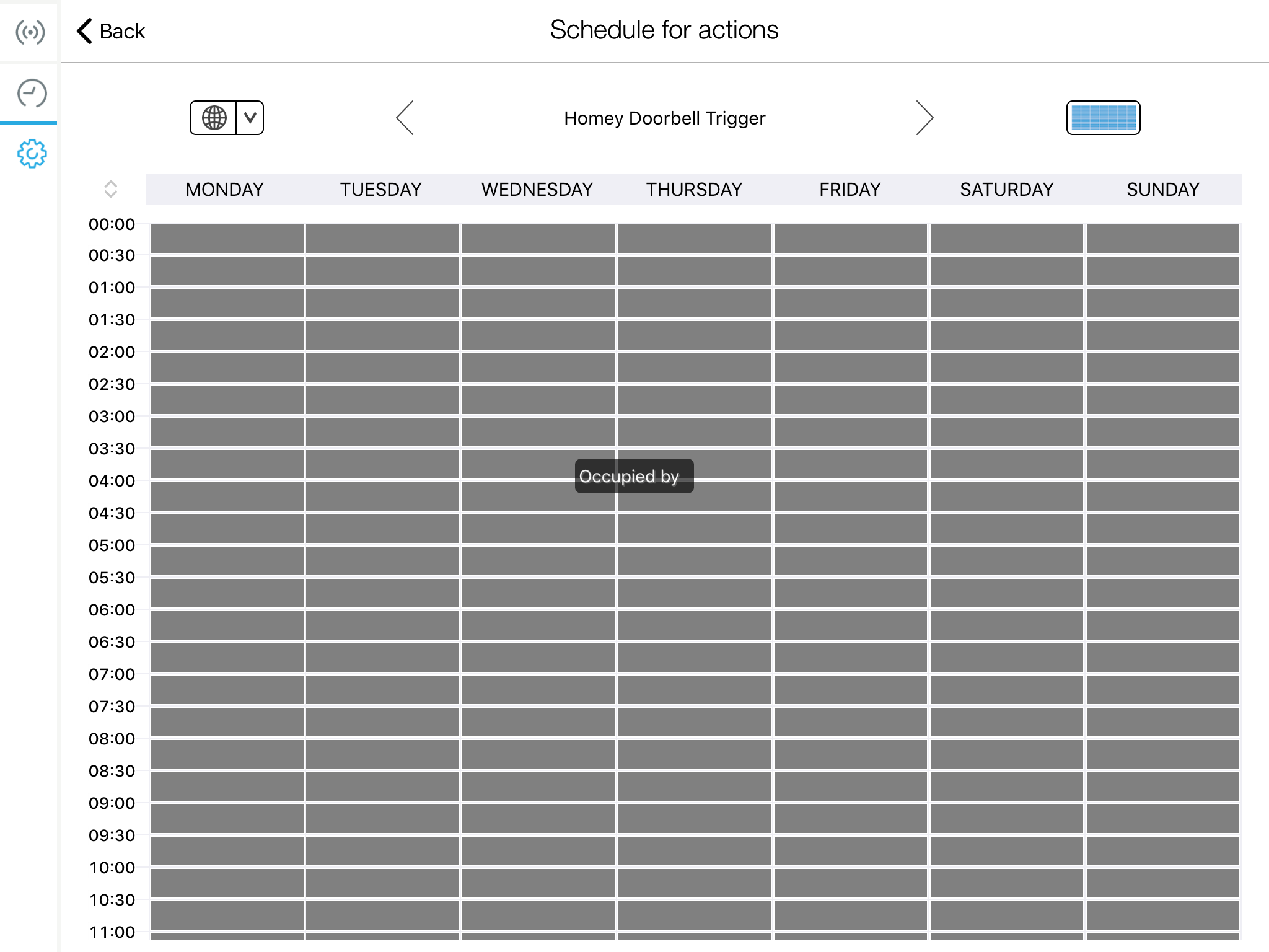

The add button for adding the http calls is working, but there is now a problem to set the Schedule for all three calls.
They are now occupied?

read the instruction carefully!
Go back twice and then in an other menu (not this, you can only select a schedule once).
(have had the same mistake)
@M_a_r_c_o
Thanks for your reply, I have done that only the relay schedule is working.
  1. try to set the motion http call in the motion schedule that’s occupied.
  2. set the relay http call in the relay schedule that’s working.
  3. Try to set doorbell http calls in the doorbell schedule that’s occupied.

You need to select the correct trigger for the right schedule (as described in the instructions). If it’s greyed out it means you have assigned the doorbell trigger to another schedule (the relay or the motion). Go back there and make sure you select the correct trigger for each schedule.
