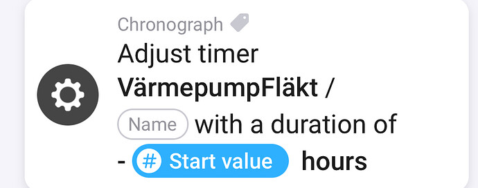

I have a number in a tag (a flow started with a number), and want to adjust a running timer by adding N hours to it.
I must have a negative number to add to the timer?
I tries this but cannot get it to work
If you want to add a number and you have -2 you maybe can multiply it with -1. The outcome is then 2. If you want to add a negative number and you have a positive number also multiply by -1
Thanks- but unfortunately that does not work either, maybe you cannot use tags with calculations at all in the Adjustment field.
If I try to use a Voltage card for this flow the timer will get set to 227 minutes.
3:47:00.
Only when the tag get changed it will not update, you first have to stop te timer.
Think that will work.
Maybe @Arie_J_Godschalk has an idea to replace the timer with a tag.
I figured out now why it does not work for me - I missed the constraint “One can’t extend the duration, when the new duration will be longer than the timer’s original duration”
