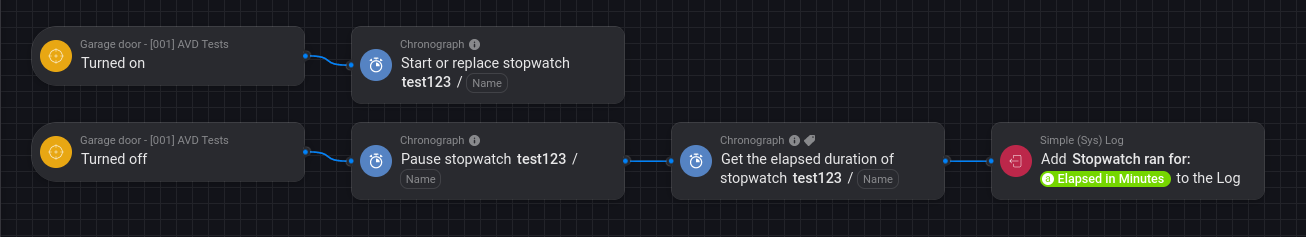

I’m experimenting a bit with this app. In this example, I want to know how many seconds it takes for the motion sensor to indicate that no motion has been detected. I have this working when I remove the “Stop stopwatch Overflow test” block. However, in that case, I get a value of 0.02 seconds. Not exactly what I intended…
The error occurs in the “Get elapsed duration of stopwatch Overflow test” block.

The [Bewegingsalarm] tag you entered is useless. When you create timers/stopwatches, just ignore that field after the /
