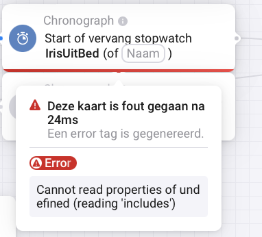

if i want to start a stopwatch, this one was already excisiting beforde the ’ pick-update’, i get this error:
Scherm­afbeelding 2023-05-22 om 16.09.32
Trying to solve it, hang on.
Well, this was fun.
I was testing with the Start or Resume card, which turned out to have a bug in it and didn’t trigger the Reached card at all.
I have fixed that and also resolved the error.
Try version 2.0.8
On the HP2023, you might need to press save on one single flow that has the Stopwatch Reached card.

When running the “start and replace” stopwatch card for the first time, it gives the above error. The stopwatch will also appear in the overview of stopwatches, but it will remain at 00.00. On a second run, the card is executed correctly and the timer starts running.
Pausing and stopping the timer works.
The Reached-card is still not executed. This after saving several times.
If the stopwatch has stopped, it will give the above error message when running again. It will run on a second run.

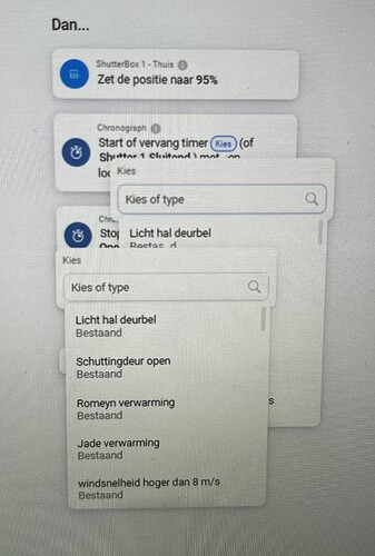

Hi Arie,
After the update, if I open a standard flow, all drop-down menu’s are opened automatically.
On advanced flows it works like expected.
Can you reproduce this?
See attached picture.
Best regards,
Eric
Edit: if I choose the correct timers from the drop-down-list and then save the flow it doesn’t happen anymore….but that would mean I have to update all my standard flows…
