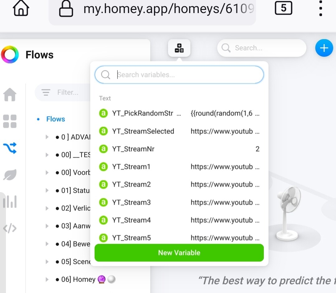

Just to be clear, the build-in Logic variables has nothing to do with this:
Found it (note that double quotes are required, like in your initial example:
let timerName = “YourTimerNameHere”). I looked in the wrong place by checking under Variables (Logic variables). I guess that the global variables can only be found within a flow card? How do I remove a global variable?
