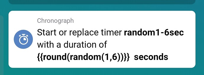

@Arie_J_Godschalk: I searched the forum but couldn’t find the answer. is it possible to use random timers? if so, how?
You can use this. The example sets the duration to a random number from 1 to 6:
Timer duration value:
{{round(random(1,6))}}

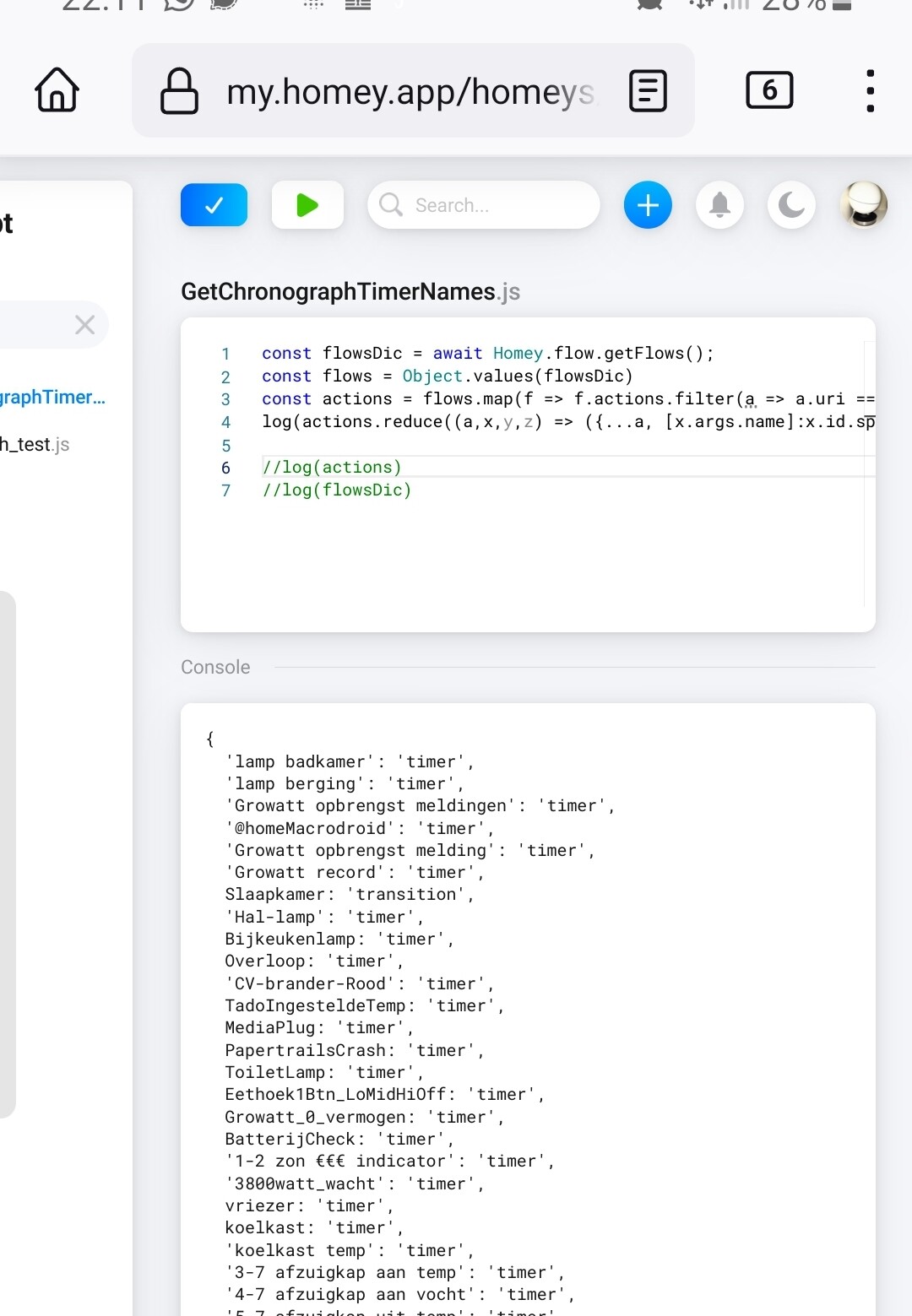

For the time being you can use this Homeyscript:
const flowsDic = await Homey.flow.getFlows();
const flows = Object.values(flowsDic)
const actions = flows.map(f => f.actions.filter(a => a.uri === 'homey:app:nl.fellownet.chronograph')).flat()
log(actions.reduce((a,x,y,z) => ({...a, [x.args.name]:x.id.split('_')[0] }), {}))

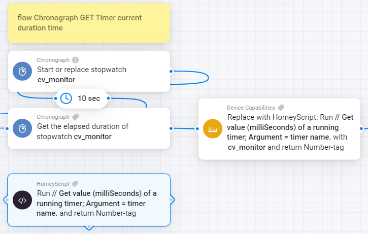

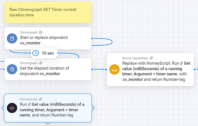

  1. I have the script cv_monitor.js in homeyscript.
  2. I revised the Chronograph flow to test with a stopwatch.
  3. I created in the same flow a script card with cv_monitor
    But I get an error from the DC card: Flow Card not registered (type: action, id: hs_runCodeWithArgReturnsNumber)?
Update: I just found out: replace the fake DC card wiht the HomeyScript card…Apologies
You have to replace the DC card with te HS card.
And the example HS card you show, uses the timer name as argument, this was before Arie made the duration/elapsed time tags available. So with the situation on your screenshot, you don’t need the two Chronograph cards.

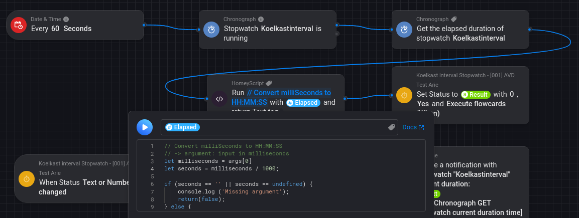

Does this make sense as example, now the HS card only converts the [Elapsed] tag to hh:mm:ss in a returned text-tag
This is the used script:
// Convert milliSeconds to HH:MM:SS
// -> argument: input in milliseconds
let milliseconds = args[0]
let seconds = milliseconds / 1000;
if (seconds == '' || seconds == undefined) {
    console.log ('Missing argument');
    return(false);
} else {
  d = seconds;
  var h = Math.floor(d / 3600);
  var m = Math.floor(d % 3600 / 60);
  var s = Math.floor(d % 3600 % 60);
  // Show as 'HH:MM:SS'
  var clock = ('0' + h).slice(-2) + ":" + ('0' + m).slice(-2) + ":" + ('0' + s).slice(-2);
console.log(clock);
return(clock);
