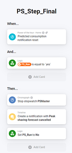

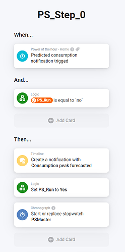

Hei
Not really sure what I am doing wrong. I have a few flows that should start stopwatches but nothing is happening.
When I “install the devices” and click on one of these stopwatches its like I cant start them. I would press the “start/stop” button and they d just blink but nothing would be started. Really weird.
I have no flow that would prevent any stopwatch from starting… I have tried to restart the app a few times without any effect. Help is appreciated :slight_smile: thx
No need for installing devices for using timers/stopwatches/transitions
Just make sure you use unique names for your timers/stopwatches/transitions
Yes I know, I have installed the devices afterwards only to check what was going wrong.
Their names are unique.
Upload your flow for us to have a look at it.
I do get a notification in the timeline from PS_Step_0 but nothing related to stopwatches seems to happen thereafter.
Have you looked in the Chronograph-app’s settings page to see if the stopwatches are running when expected?
Is Elwof home and charging? Print something to the timeline (Simplelog is very nice for logging BTW) for all then-else to see what is going on.
I do not think PS_Step_2 will work. If I remember correctly it is not possible to have a dynamic time-check in the when-card.
Ps step 2 will not work: the duration has reached cannot be given a tag/token.
Thanks all.
The Tesla app wasnt providing reliable data about the car, so I have set a condition on the EV charger power instead.
And yes the step 2++ flows did not work as I used a variable in the duration.
This now seems to work. Thanks!

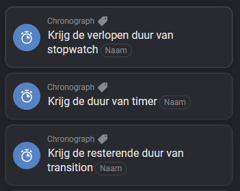

Now in Test:
New flowcards:
Retrieve the (elapsed) duration of timers, stopwatches and transitions.
You will get Number tokens if applicable:
  • Duration (ms)
  • Duration (Seconds)
  • Duration (Minutes)
  • Duration (Hours)
  • Elapsed (ms)
  • Elapsed (Seconds)
  • Elapsed (Minutes)
  • Elapsed (Hours)
