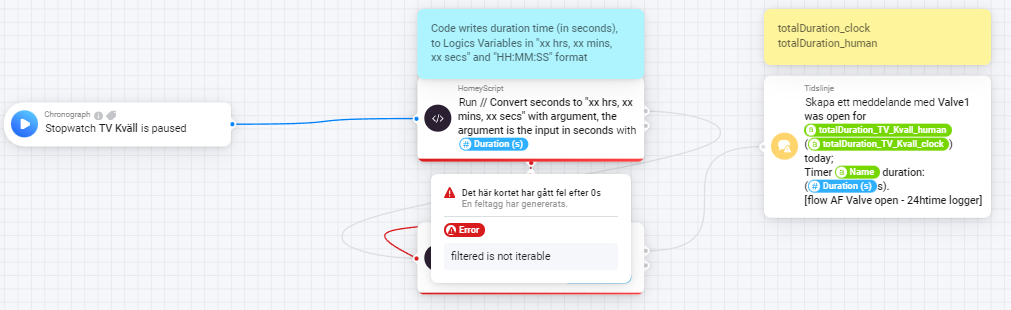

Thank you for the quick response. Unfortunaly i couldn’t get the flow with homeyscript to work, it would have been neat since the format HH:MM would have been nice. I used device capabilites, changed all variables and entitie names and imported the flow. Once the flow was imported i changed the card to homeyscript with argument and copy/pasted the code but i get an error when i try to run it. It says it cant find the variable. Any quick “pointers” to were i could have gone wrong? I haven’t used homeyscripts before (as you most likely already figured out)

However i cant get the stopwatch to work. I changed the device “valve1” so that my TV starts and stops the timer in chronograph. I changed the template with a “HS run code with argument” and copy pasted the code but i get an error that it doesnt find the variable. Before i test the script i start and stop the stopwatch so that i have a stopwatch in chronograph named “tv” that is paused.
is there any variable that im missing or could it be something in how i replace the dummycard with the HS-card?
Edited: My bad, Fredrik, the logics var ID’s were hardcoded, that doesn’t work on other Homey’s ofcourse. I also changed the Dutch var names to English ones.
I made some adjustments, it should run OK now:
Hi! Once again thank you for your time looking at this, much appreciated. I cant, however, seem to get it to work. I tried the new TFE import and got a new error, it says “filtered is not iterable”. Since you mention hardcoded english i tried removing the swedish letters in the name for the chronograph stopwatch (not in the screenshot) but i got the same error. I also tried copy paste the HS-flowcard and put it in a new flow with the same triggers for the stopwatch but with the same result.

  • I didn’t realize the var names could be altered :crazy_face: . I adjusted the argument input, it now holds the (editable) variable name as well

When you want to change variable names,
mind to change it in the arguments bar of the homeyscript cards as well. Example for the
totalDuration_human variable name:
Screenshot from 2022-10-12 01-03-07

Thank you! That did the trick :smiley:
