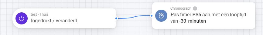

Thanks for the reply, but thats not quite what I mean. I have a timer that my TV turns off when 1,5 hours has passed. This Tv has the PS5 attached to it. So you get the idea.
Sometimes I want to extend the timer with let’s say 30min.
So I created a virtual switch (doorbell → pulse) witch activates the flow above. But the chronograph card does not behave as intended/expected. This card should extend the timer by 30mins in case of a positive value and decrease by -30 mins with a negative value.
Ah ok, so I can only add 30mins when the timer is below one hour (initial time was 1,5 hours)
I don’t actualy understand why this is the case. But good to know.
Thanks for testing!
YW!
It’s a matter of how one looks at it.
This way you cannot ‘by accident’ change a 60m timer into a 60hrs timer.
OR
You can only change values within the defined timer duration.
Or it is just impossible the way the app is written.
It’s also the way one looks at it:
In this case, +30mins fastforwards the timer, -30mins rewinds the timer

I have flow where I sometimes want to extend a running timer. Then I tried the card ADJUST TIMER. But the help text is wrong compared to how it works. If I adjust with +60 minutes it is instead shortened, and vice versa. So I got it to work but it is not correct.

So the solution could be to just adjust the help text with your example of text. For the developer (or hopefully someone that takes over)
Yeah indeed, the help text says the opposite.
