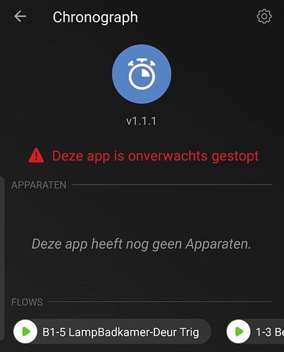

Hi Bob,
Homey v7.3.0
Chronograph v1.1.1
Chronograph “stopped unexpected” a few times a day, since I use it after Homey’s factory reset with my restored backup…
It worked fine for about 18 months.
However, the flows luckily don’t get broken (because there’re no devices), and the running timers just keep on running!
I’m going to re-install Chronograph
Uninstall and then install will cripple my flows I think?
2e7c7ce6-ac2b-439a-a70c-fa3787d50bdf
All the best,
~Peter
Hi Peter,
I don’t want to disappoint you but Bob doesn’t seem to be answering any questions for quite some time.
But just try a reinstall, I’m also interested in whether the flows are affected by this, in the worst case you have a backup :wink:
Thanks Joka, that caught my eye too. But I love this app.
I will do some ‘experiments’. I have indeed a backup :upside_down_face:
A re-install without uninstalling first, keeps the flows unaltered.
I don’t want to fiddle with restoring backups yet… so I don’t uninstall it for now.
I will keep an eye on things, f.i. what happens as the app has crashed. The timers seem to keep running anyway…
Probably only new flow cards cannot be added.
~Peter

@Peter_Kawa Quite a while later after your message: I can confirm that uninstalling and then installing Chronograph will restore existing flows intact.
The reason for the need to uninstall is that app restarts could not keep Chronograph from crashing. No idea why, but we are quite a few releases further and I am in the process of setting up new advanced flows with Chronograph.
Hi Peter,
I had the same experience: application crashed and even reinstalling was not solving the issue.
What helped me was 2 things:
  • I did setup a chronograph as a device to be able to see the progress. After deleting the device I was able to use the app again
  • I changed all my chronograph to timers.
I have not experienced any crashes after above changes. I hope this helps.
Dyan
Thanx Dyan. The odd thing is, all’s working fine, even when the status is This app has unexpectedly stopped. Even the flow cards stay ‘valid’.
Meaning you ditched all stopwatches and transitions?
Hi Peter,
Yes I changed all stopwatches to timers. I have not used transitions.
Dyan
