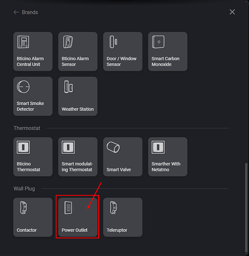

Hi, it doesn’t find my smart switches, I have 8 at home, connected to the bticino gateway. The enter and exit button has been found.
What can I do?
My code log
92e7a3e6-d51f-47e5-999e-5b980666f9d9
Thank you so much!
@Diego_Cervia -
I got your logs.
From the logs, I can see that you have the following devices:
  1. 1 Energy Meter, 1 Remote control and 1 Termostat, which were adde sucesfully
  2. 9 Light Switches, which were not added. In order to add them, you should choose “Light Switch” (Verlichtingsschakelaar) while adding the device:
  3. 1 Power Outlet, which was not added. In order to add it, you shoud choose “Power Outlet” (Stopcontact) while adding the device:
Let me know if it helps.
Yeah, it works!
Thank you so much, your work is very much appreciated!
Great, glad I could help
