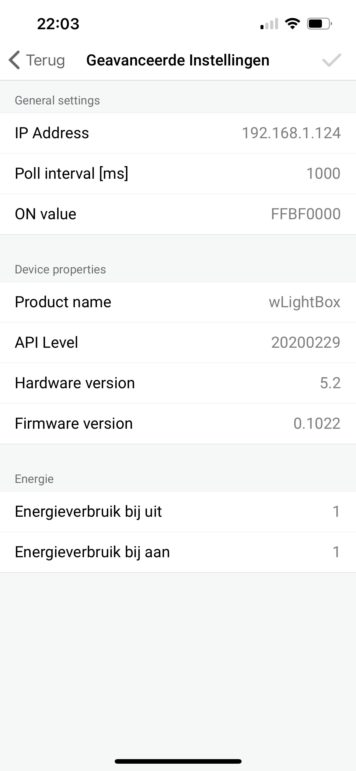

Well, I have a RGB ledstrip that needs to turn on every day at a specific time in the standard color (the on-value in the settings)
But sometimes it’s need to go on in a completely different color.
The only way I can get it to work is to first turn it on (in the standard color) and then change the color.
Or is there another way?

And only “Verander naar kleur <>” without “Zet aan” doesn’t work for you? Because I think it should (or I’ve got a bug there). What happens if you send only this command? What exact LED tape do you have (RGB 3 channel or RGBW 4 channel? In which mode is wLightBox configured in wBox?)? Thanks for all the answers, I’d like to troubleshoot this problem.
No, only “Verander naar kleur” does nothing.
If it’s not on already, I can’t change the color.
It’s a RGBW LED strip and also set as RGBW in the settings

It looks like I have a bug with setting the right color with the flow. I’ll have to investigate it further. I’ll let you know as soon as the patched version is ready for test. It should then work properly with just “Verander naar kleur”.
Personally I don’t see it as a bug…
I think it’s not strange that I first have to turn it on, before I can change the color.
I would prefer to change the way to set the On-value in stead, so it isn’t needed to use HEX anymore.
Something like:
First set the Ledstrip in the preferred color with the RGB sliders or a color-picker.
Then press a button: Use this color as default ON-value.
Just an idea……
